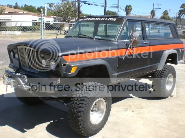

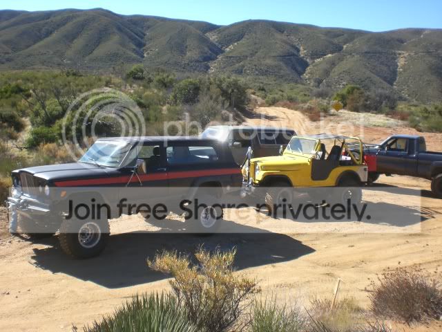

I have a 74 Jeep FSJ that is smog exempt here in California because it is pre 1975. I was given a totally sweet 77K5 Jimmy with a totally thrashed body. So I added 2.5 inches to the frame length and lengthened the drive shaft on the Jimmy and swapped the body. Now I have a great, mechanically sound chevy and a pre smog vehicle. Was hoping I could still hang out here even if its not what your used to seeing?
This is how Tweekers prep for paint. And the reason I didnt use the Jimmy.

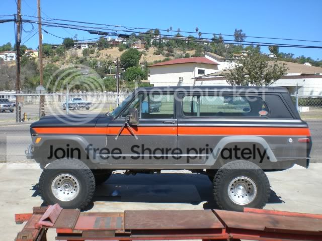

Some side by side comparison.

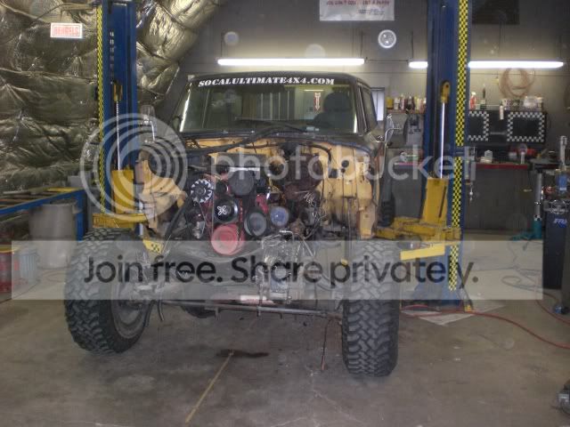

The swap...

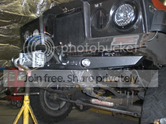

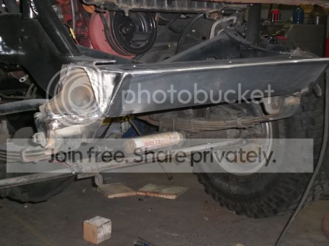

I need to do a shackle flip and loose the blocks that were on the K5 lift kit. Then I want to get it up on some 38's, these 35's look a little too small IMHO. Im looking at a 14 bolt that I can re gear to 488 or so and a disc conversion . This is just a tow / recovery rig for a tube car that I am building.

Thanx max 02. Its kinda of funny how the Jeep folks turn their noses up when they find out its a blazer. And most of the Blazer guys just cant understand why I changed a beautiful Blazer body for that thing. I am having fun creating something different and to be honest I couldnt of made the Jeep look this good with Jeep components.

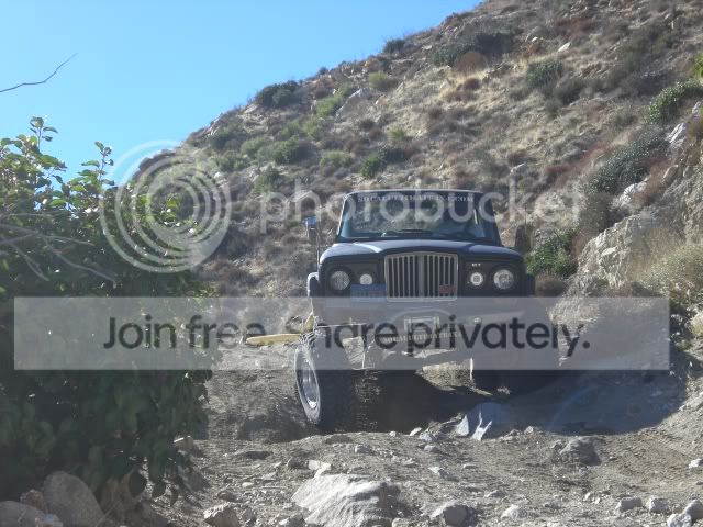

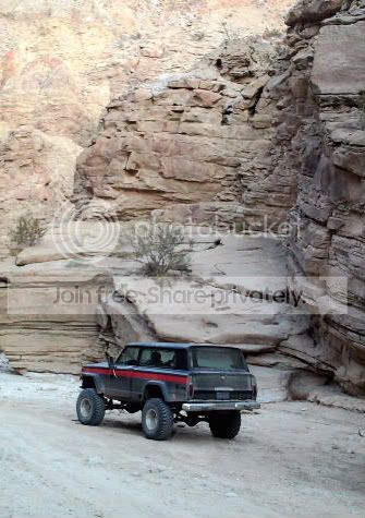

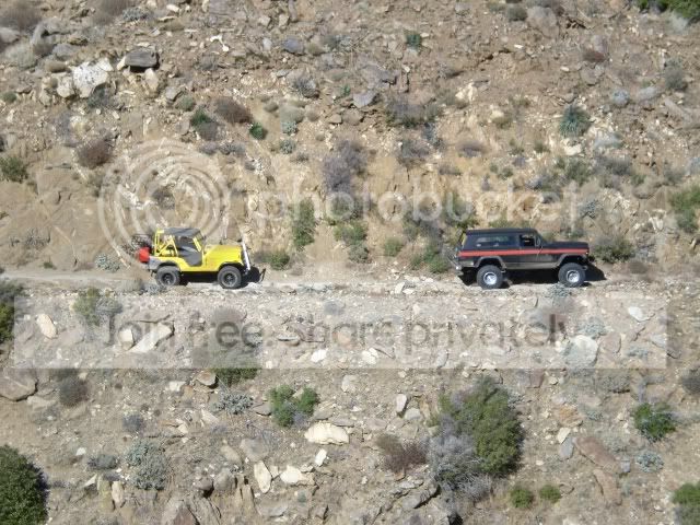

Finally got around this weekend to doing a shake down run. Did a 185 mile loop through San Diego's back country to the desert floor and back home. Only issue was a fan shroud got loose and took out my new electric fan and good used radiator. :doah:We did the Mcgyver thing and drove her home. Other than a few loose bolts I was really impressed with what the streched Blazer could do. High steer is next.:rolleyes: Thanks for all the help here guys.:thumb:
