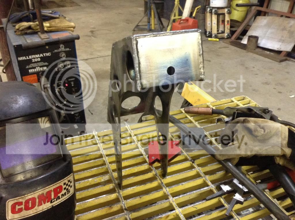

hey bro i just scored a set of these shocks for free from a customer, are they a direct bolt on???? i have 4"leafs in front and 4" leafs in rear. thanks for any help brotha!
Haha I wish.
But I have some parts to make them bolt in once you weld my parts in :D
Idk where that is, but $100 shipped and they are yours. Uppers and lowers
Don't need this for me but thought a little more info would be helpful to potential buyers if you are offering parts for sale.
Is that $100 per corner, per set of 2 (front or back), or per set of 4?
Do the same brackets work in the rear or do you do something different there?
Does the $100 price include the dimpling and welding, is it just unwelded dimpled plates, or just plain jane unwelded undimpled plates?
If I were in the market to buy these from you this is info I would need to be an informed customer. :thumb:
Never really pushed on advertising because I only did one run of them and don't want to get in trouble for not being a vendor.
I think I only have one set left anyways. But it was everything to do the front axle, dimpled plates, unwelded so they fit in a flat rate, plus I didn't want to be responsible for the welds etc.
Rear is totally different.
