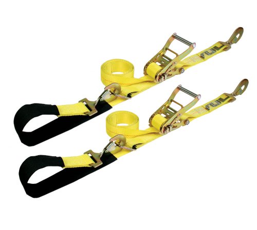

I'm looking at getting these Axle Strap Tie Downs for securing the to the Dolly. 9 1/2 feet long, 3 inch webbing with integrated axle strap and 1,600 lbs capacity each
Vulcan part #AH5210DR-K2

Had my weights mixed up earlier so sorry. I use those kinds of straps on my flatbed tow truck on an almost daily basis! I'd check and retighten after about 20 miles into your trip then every time you stop! Also if your towing behind the moving truck you will not be able to see the trailer or blazer. Not really a big deal but I used to get a little apprehensive about that. Also all the truck rental companies rent one-way. If the local dealer said round trip then check the truck rental website for rates. Might get a better deal that way. Stay away from weekends,holidays and end of the month if you can cause that's when rates go up!
