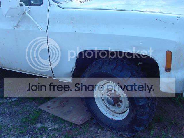

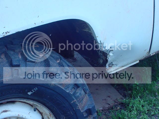

I may have done something wrong, but my paint flew everywhere. I don't want to even snap the pics and host them up. They're BAD.. I guess you need to really take you time, and make sure to only cut through masking tape.

Just wanted to show what happens if you DON'T take you time... its no biggie.. I hope to get my motor running and be beating the body to death before long :bow:
