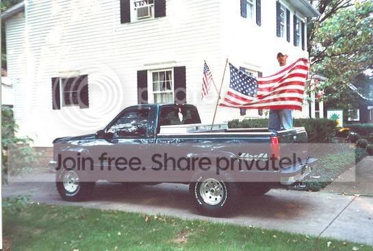

Here's a picture of my stock-height, '96 GMC I had back in 1999. It had 15x8 Mickey Thompson Classic rims with 33x12.50R15 BFG All-Terrains. I had to lop off both lower corners of my front bumper in order to run them but other than that no problems.
