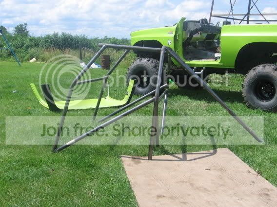

Here's what the s&W cage looks like welded up, courtesy of jaysonsk5

Looks just like this,but without the dash bar...
Still need to install 2 pieces yet and connect to frame.But you get the idea...
