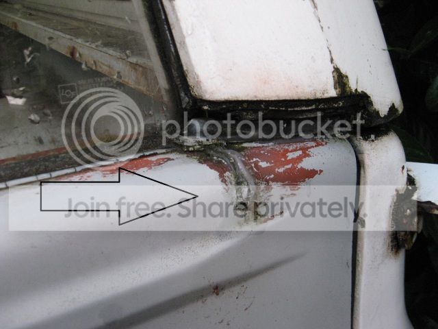

can someone post up a picture of it? never seen this crack.... :confused: :confused: :confused:
It's located under the big gob of silicone, which is on top of the layers of chipping paint, and under the fine coating of moss and the film of dirt.
(BTW, this is not the recommended fix for the issue, but it works when keeping water out of your tailgate is a priority.)
My K5 is a manual tail gate and has the crack on the passenger side. The crack however does is not vertical as in the photo but horizontal. It is about 1-2in currently. It is small enough that now is the time to weld it I think before it get any larger.

Interesting. Almost all the failures I've seen in this area resulted in vertical cracks. I don't think I've ever seen one that runs horizontally.
