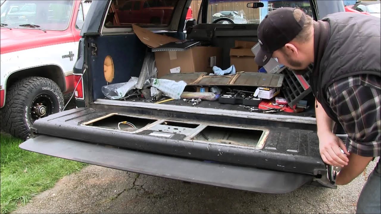

#8 is the piece that is about 2" from his right hand pinky knuckle in this pic:
Black plastic piece that is screwed to the top edge of the tailgate on either side. You can see the one interior screw clearly, the exterior one is harder to make out.
