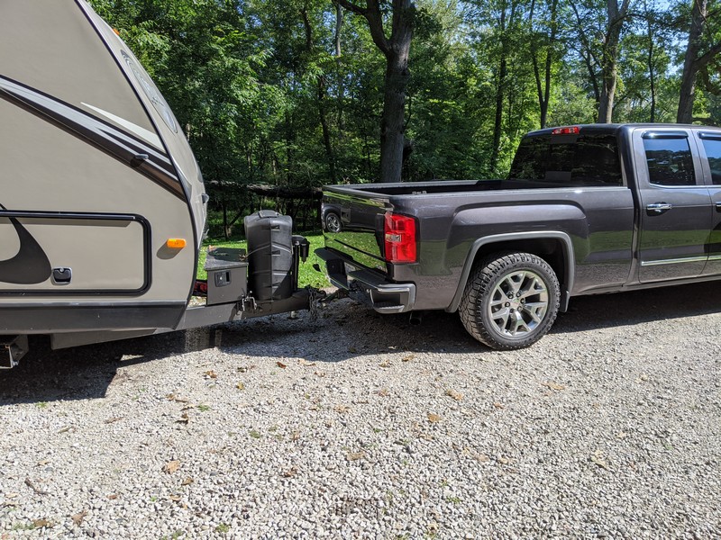

The truck has Firestone 2320 bags and Hellwig 7800 rear sway bar. It's an NHT truck that has had the 2" lift block yanked (in a feeble attempt to stop atrocious wheelhop and make it look less like it is always rolling downhill). What you see there is 1300lbs of tongue weight on empty bags.

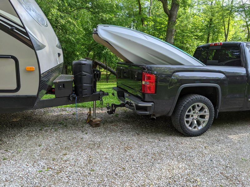

Here are the kayaks with the noses stuffed in the corners. If I put them on their sides touching in the middle they go higher up and actually make the problem less.
From here it looks like you’d hit the bumper on the truck before you’d hit the kayaks turning.
That makes sense. Just looked a little low.

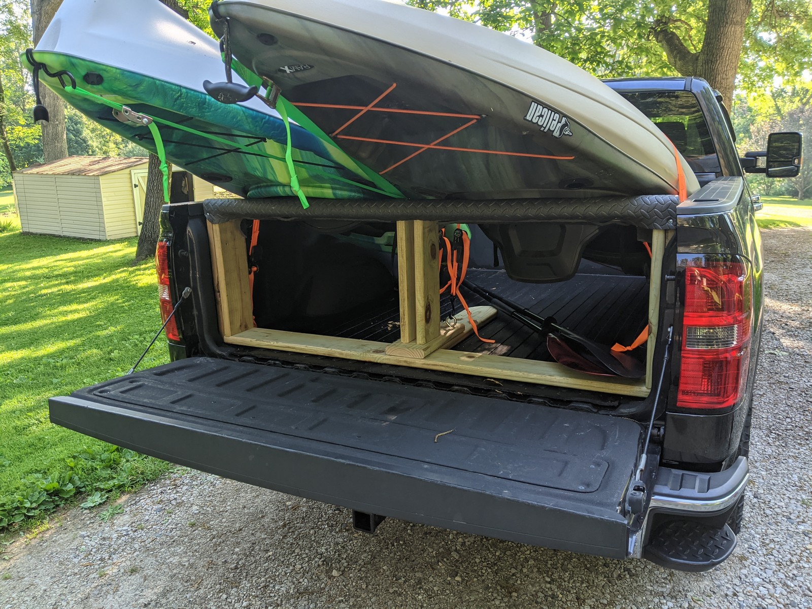

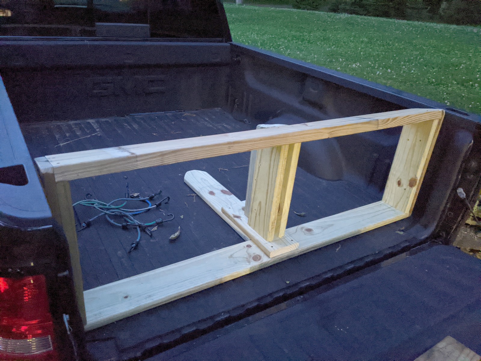

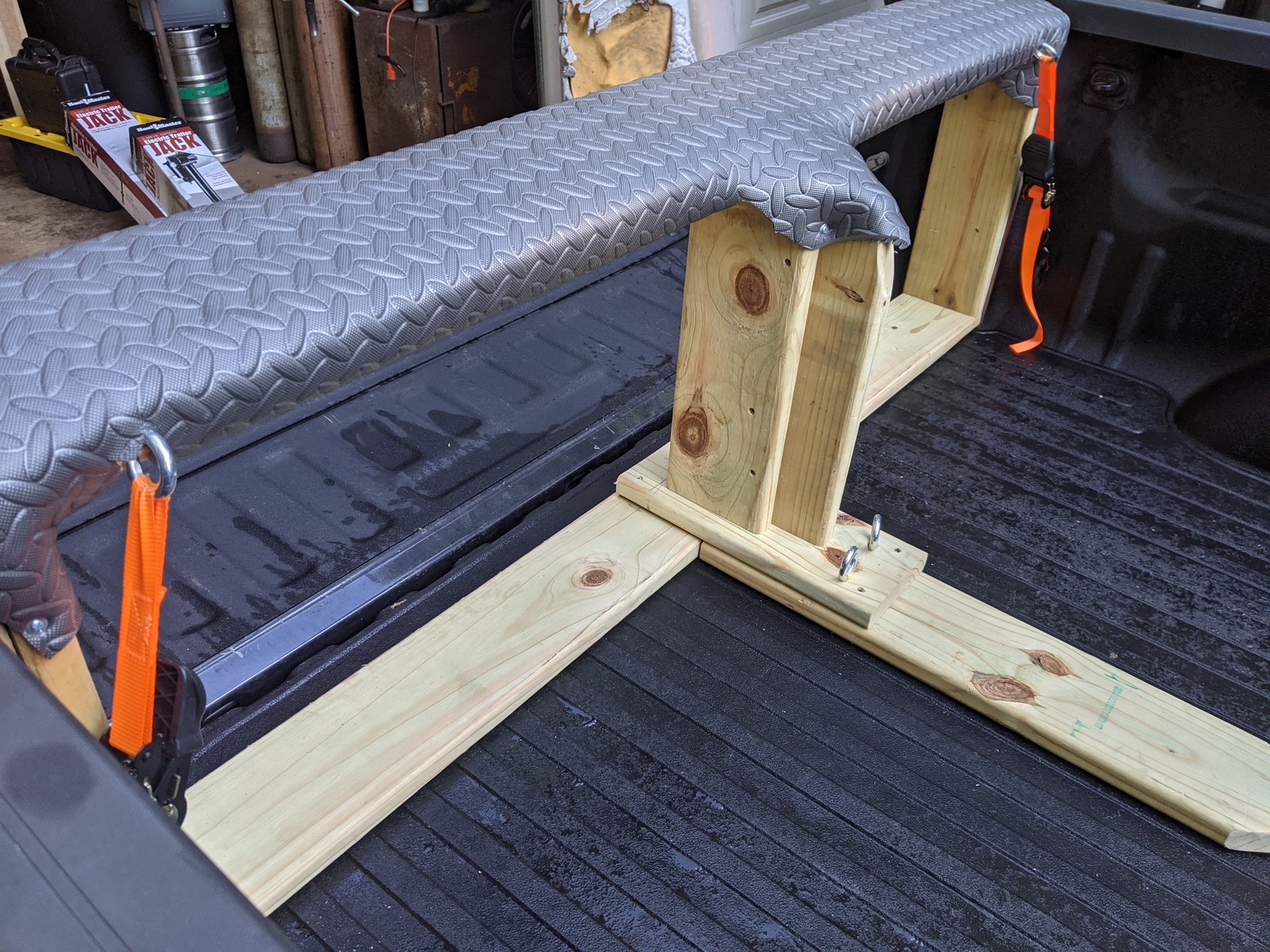

This is what I ended up with. The top 2x6 is such so I could easily through-bolt with an eyebolt and recess the nut. All of the eyebolts are through-eyebolt. I forgot to take a picture of the center one used to hold the kayaks forward.
The bags have 65lbs in them.
It may or may not have been tested to hold to 100mph without a trailer or 85mph with a trailer.
