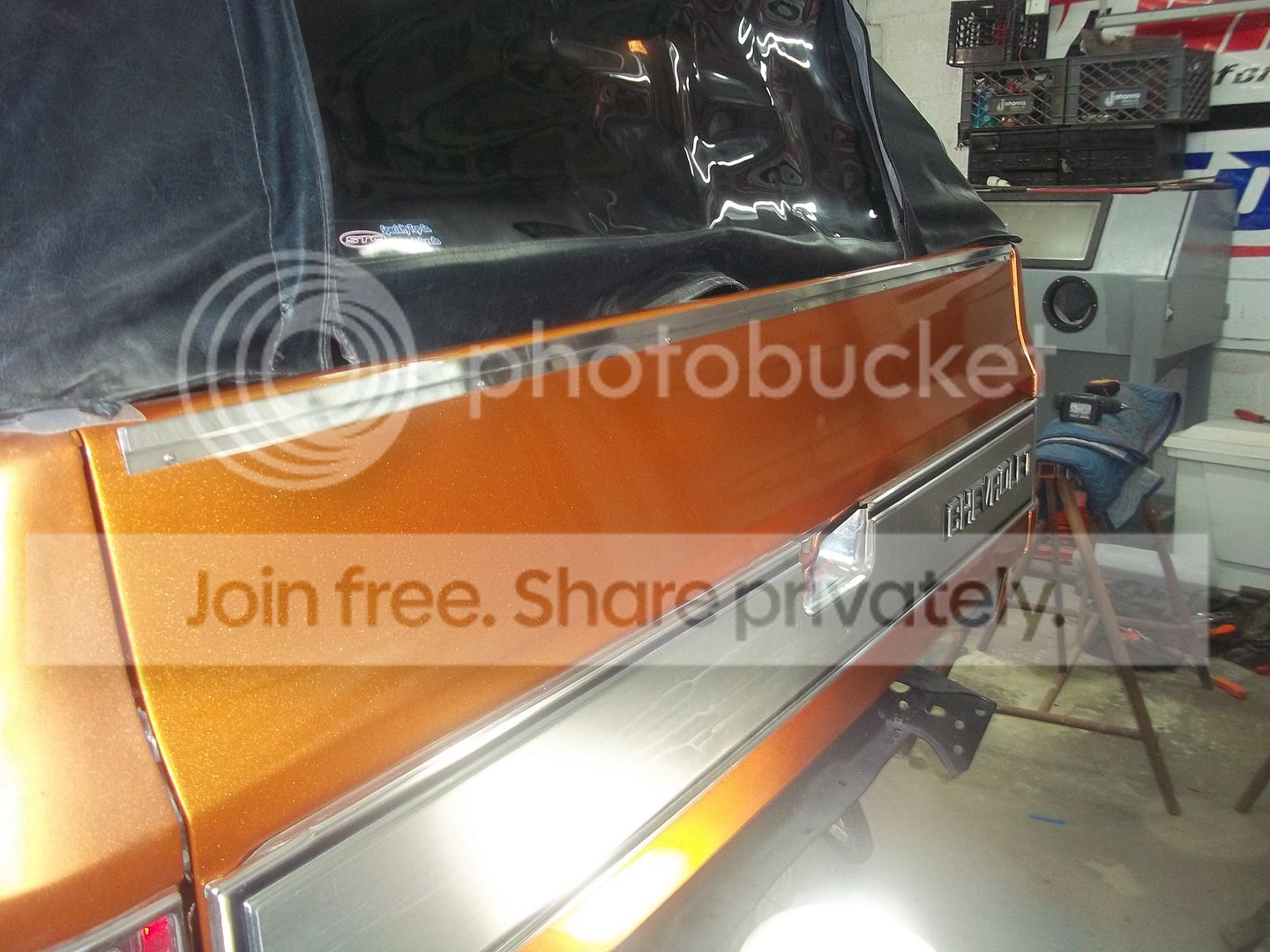

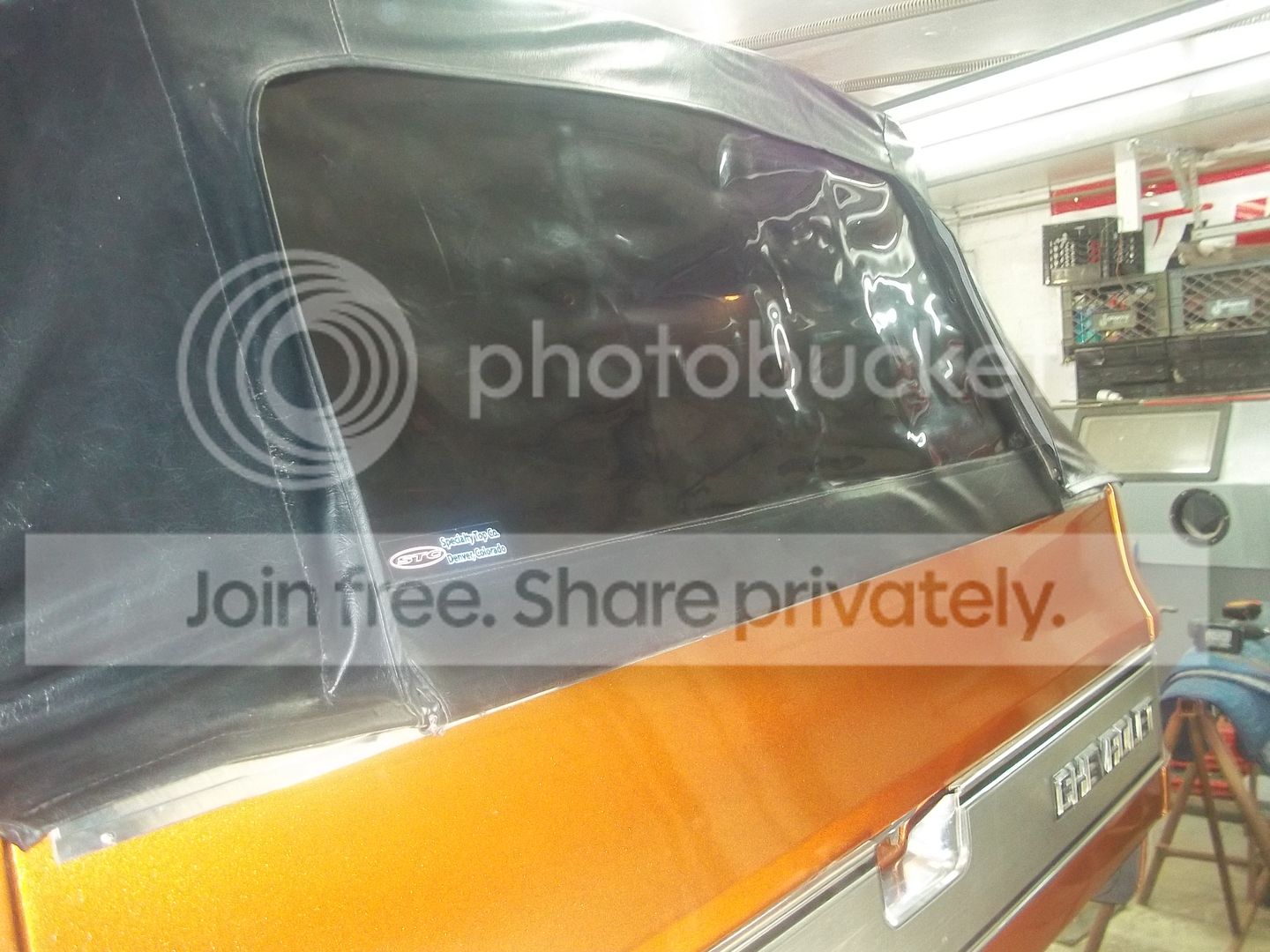

you'll notice the "wrap-arounds" from the 1/4 panel, don't hook under... mine appears to be missing the J hook plastic that runs down the sides at the bottom of the windows, sewn into the back corners.. i'll have them added, it would fit perfect with that...
I got mine second (or third or fourth) from a buddy of mine and I had the same exact problem. I ran out to Homo Depot yesterday and found some carpet grippers. Bought that, modified it a little bit, and it works really well for 7 bucks and a little bit of time.
how did you attach them to the top? I just can't see anything working well that isn't sewn into the top.. that sh*t needs to stretch to hook under the channel..
Ryoken do you know where or how I could make that piece on your tail gate? I know for sure I do not have that part of the soft top. I will have to check the corners tonight when i get out in the garage. Thanks

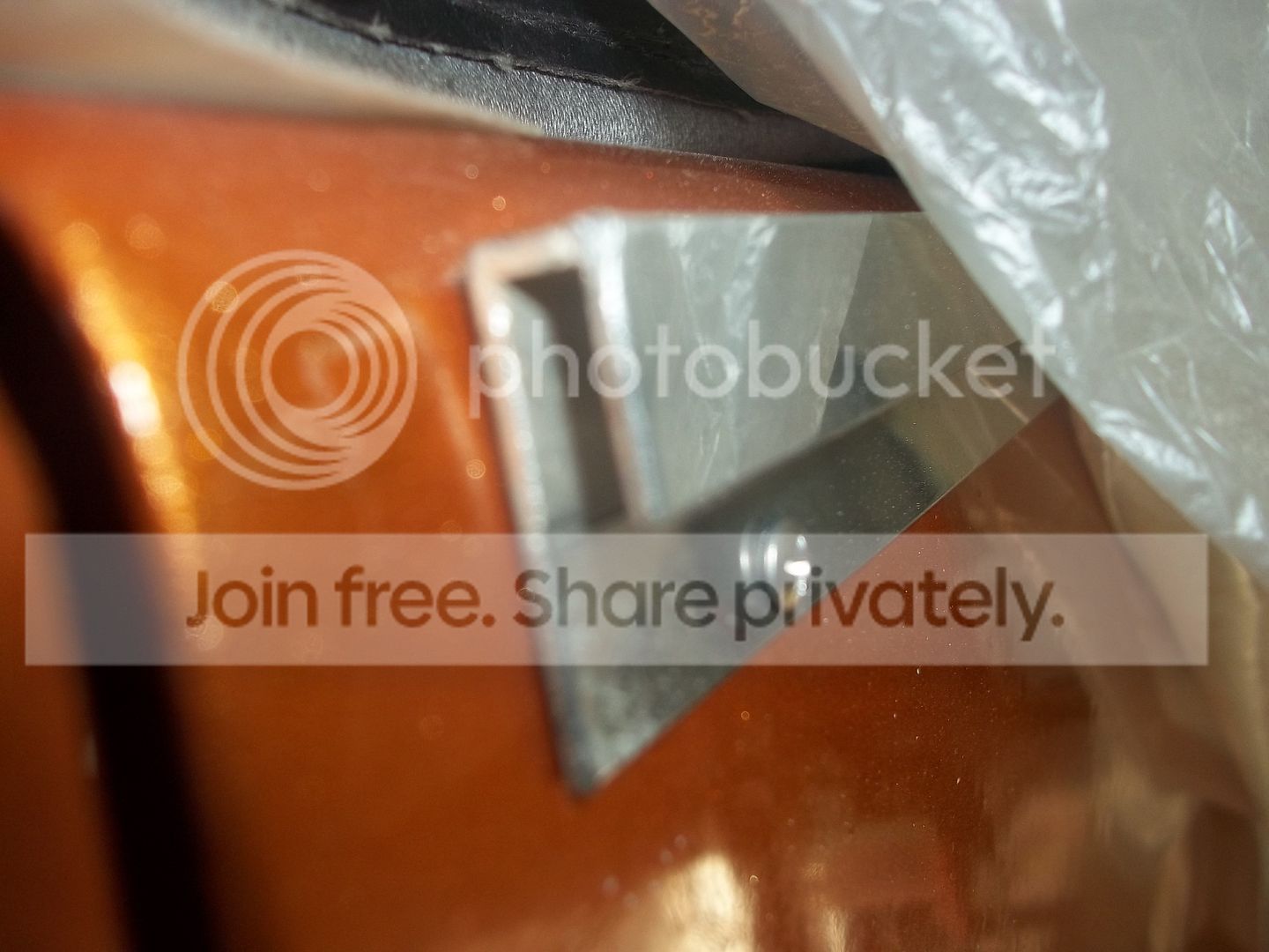

it's a "j" style piece of alum obviously... that the hard plastic at the bottom of the window tucks in...

I think I would need you to measure your J channel on your tailgate both in width and length to get the closest possible correct J channel?

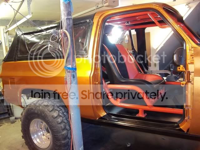

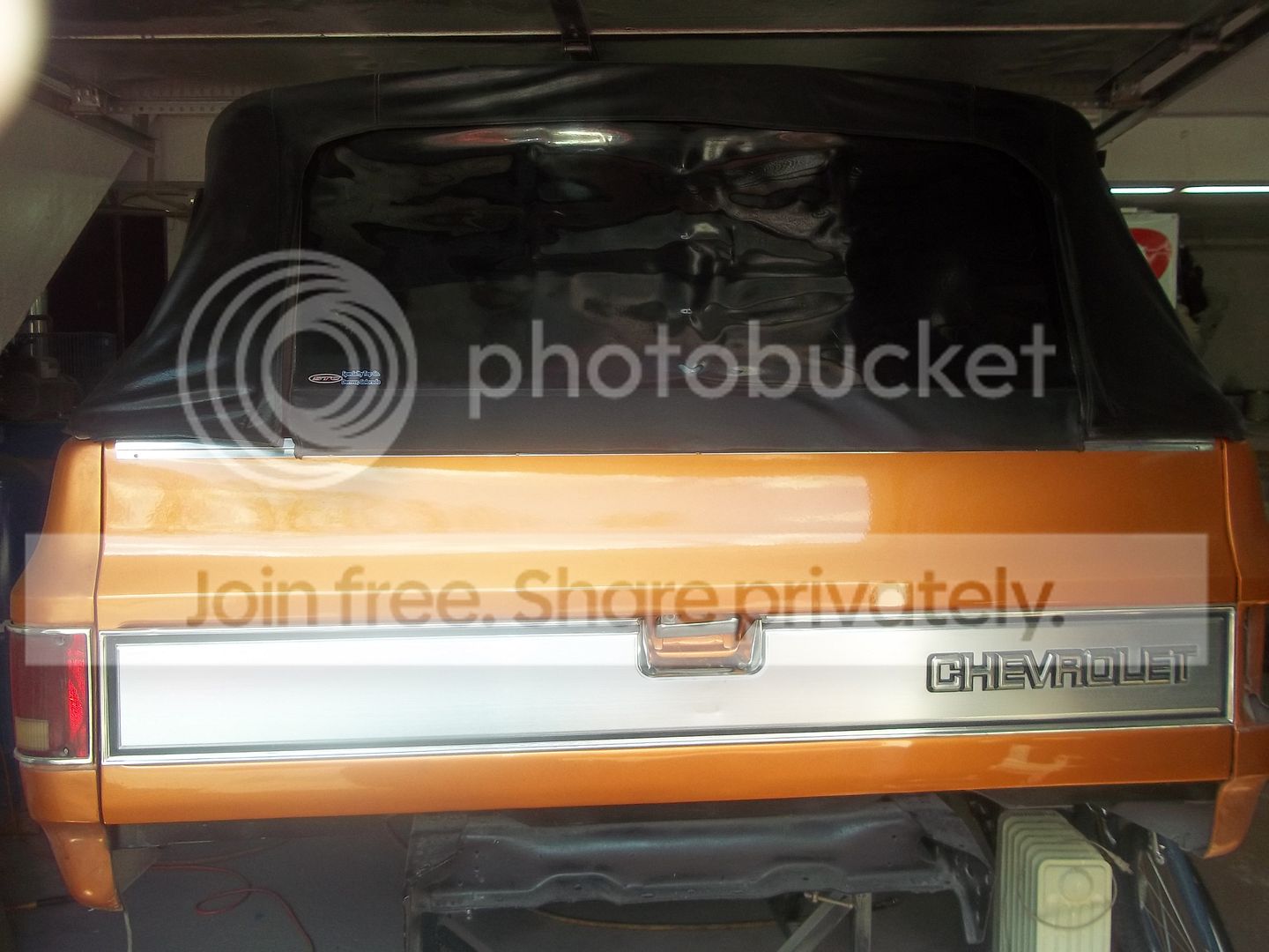

ok, went and uncovered the rig.. here's a pic of it..
it's not as deep as I thought, but a bit deeper than what I saw listed in my brief search.. the long mounting side is 1"... it than comes out a 1/4"... than the "j" lip is 1/2"
you should be able to source that somewhere.. it's alum that I polsished.... but ss would work too I suppose..
Try looking into jeep windshield channel from a cj5, I've got some around if I can find it I'll get a pic.

it's basically the width of the gate.. 65 1/2".. it has 8 screws, but you could put in any # you want..
the K5 is covered until the fall when I can get back to working on it after my CC's tubebed project... it has no axles under it, no trans... and it's not exactly a stock/bolt parts on, kinda build.. :haha:
