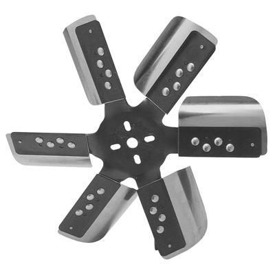

Summit Street and Strip fan
http://www.summitracing.com/parts/SUM-G4918/?rtype=10
