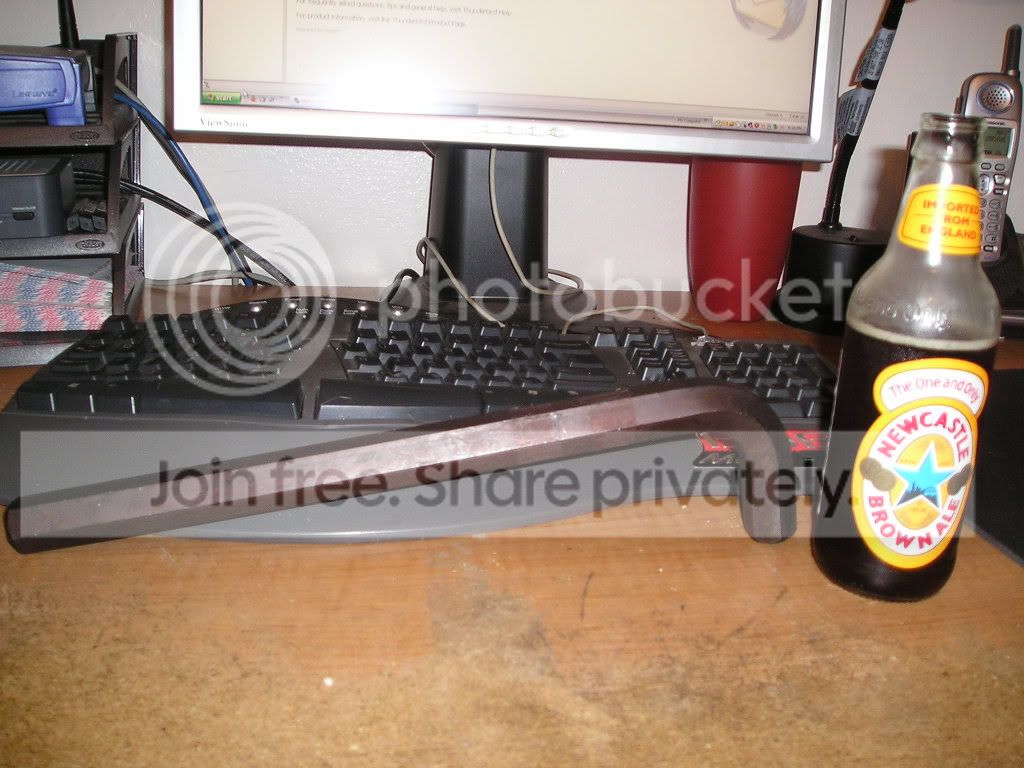

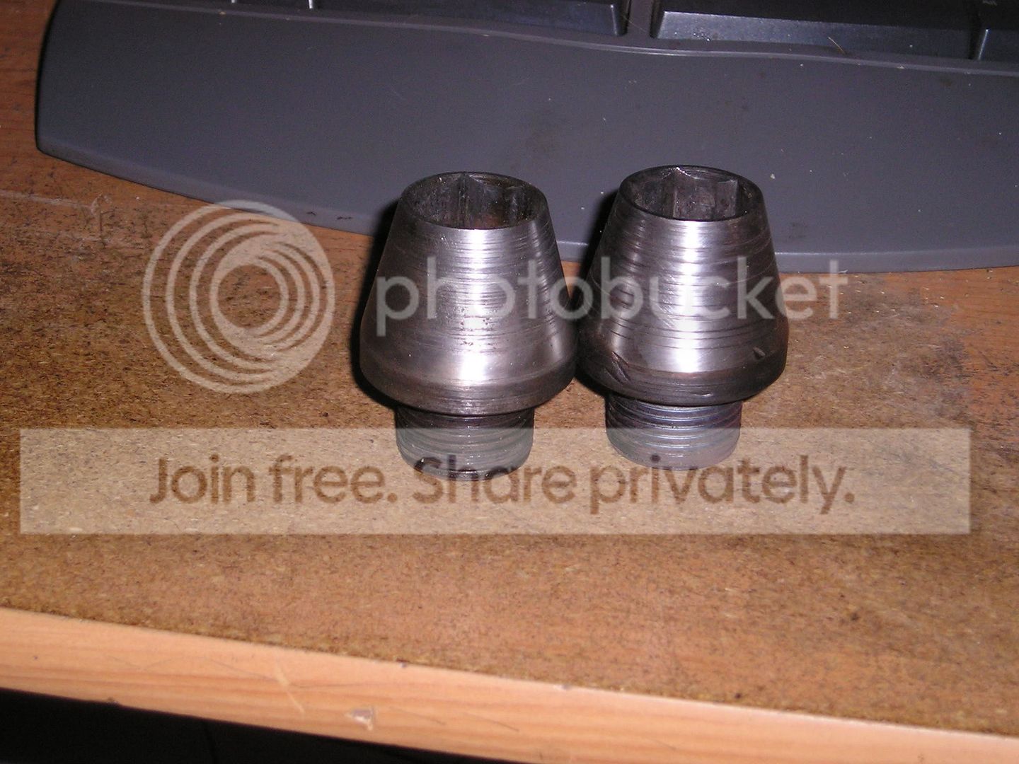

I found a 7/8" allen at Osh in Chico. $15. Stuck a 5' cheater on it and had the kingpins out in less than a minute, no heat required. :D Here's a pic of the allen with the bottle of Newcastle and the keyboard for size reference-
And the hosed kingpins-(big pic warning)
