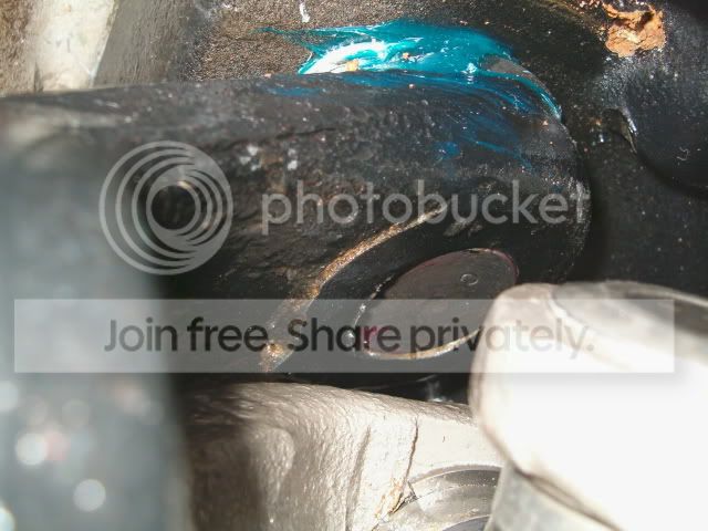

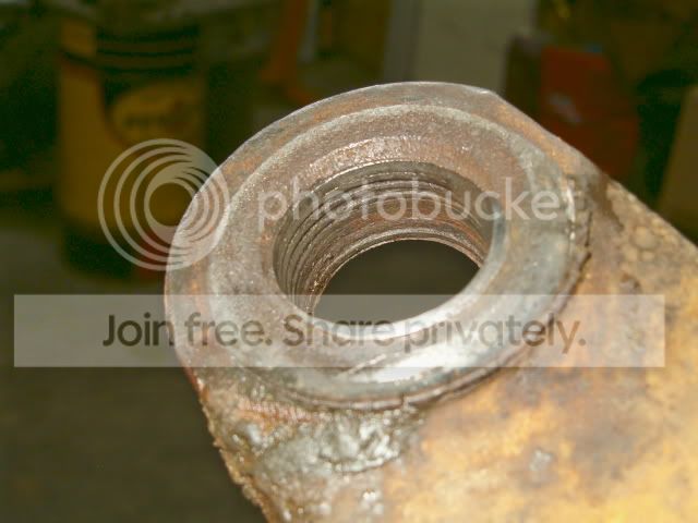

One side of mine pulled out, I didn't even have to turn it:
Repaired:
