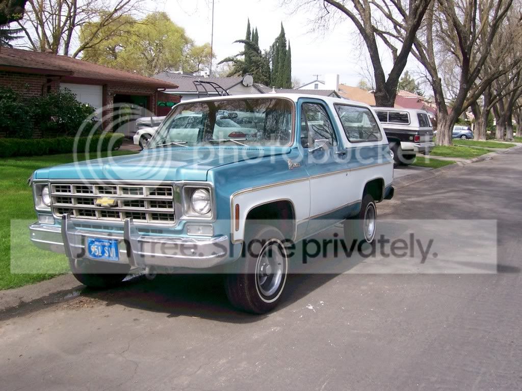

Well I figured I'd make a thread of the progression that my 77 blazer has been through so here it goes.

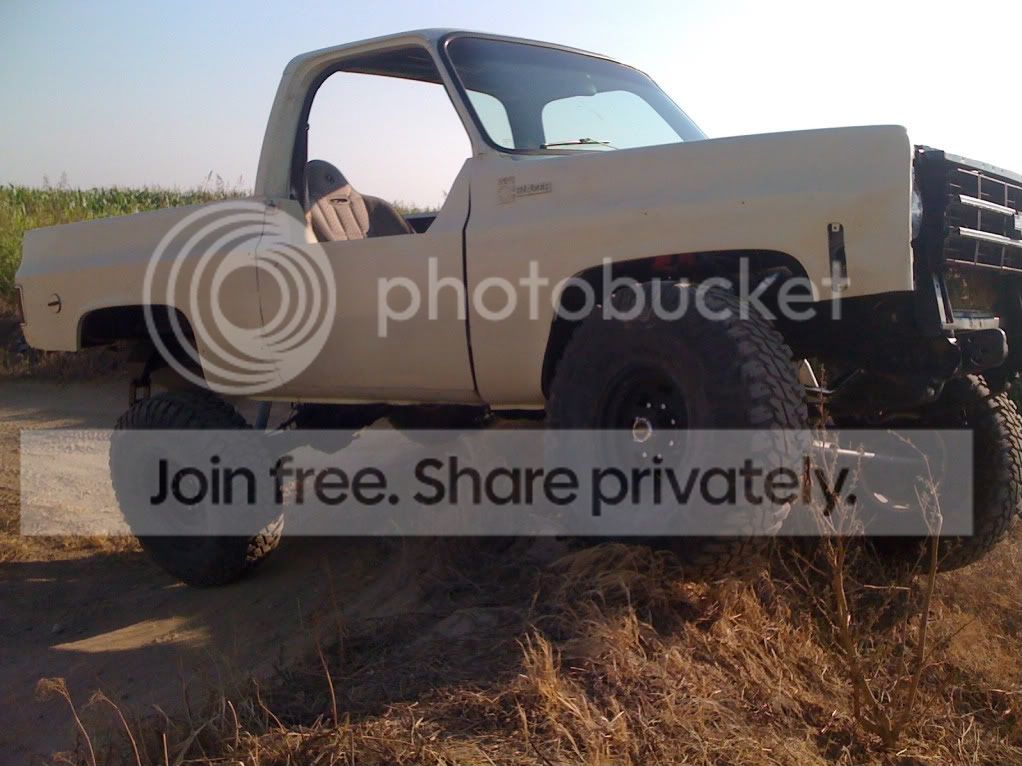

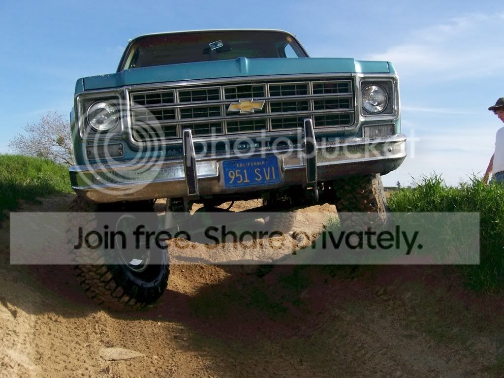

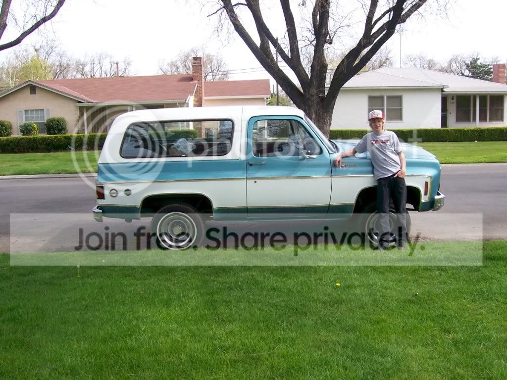

Here she is the day I brought her home, I used to love driving around town when it was stock. The 400 that came in it ran ok, but I got tired of that all time 203 very quickly:rolleyes:

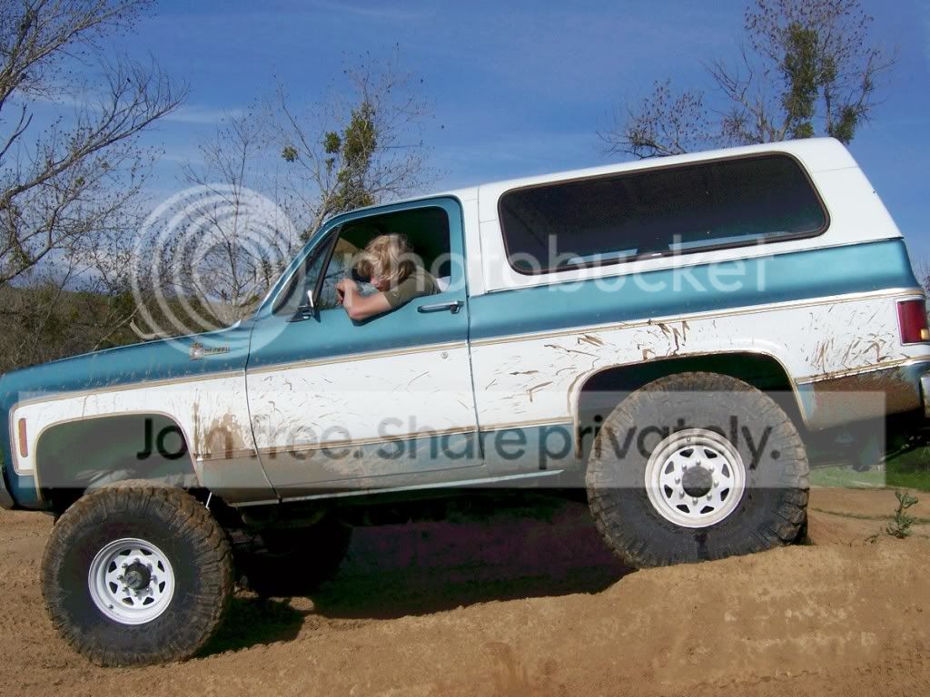

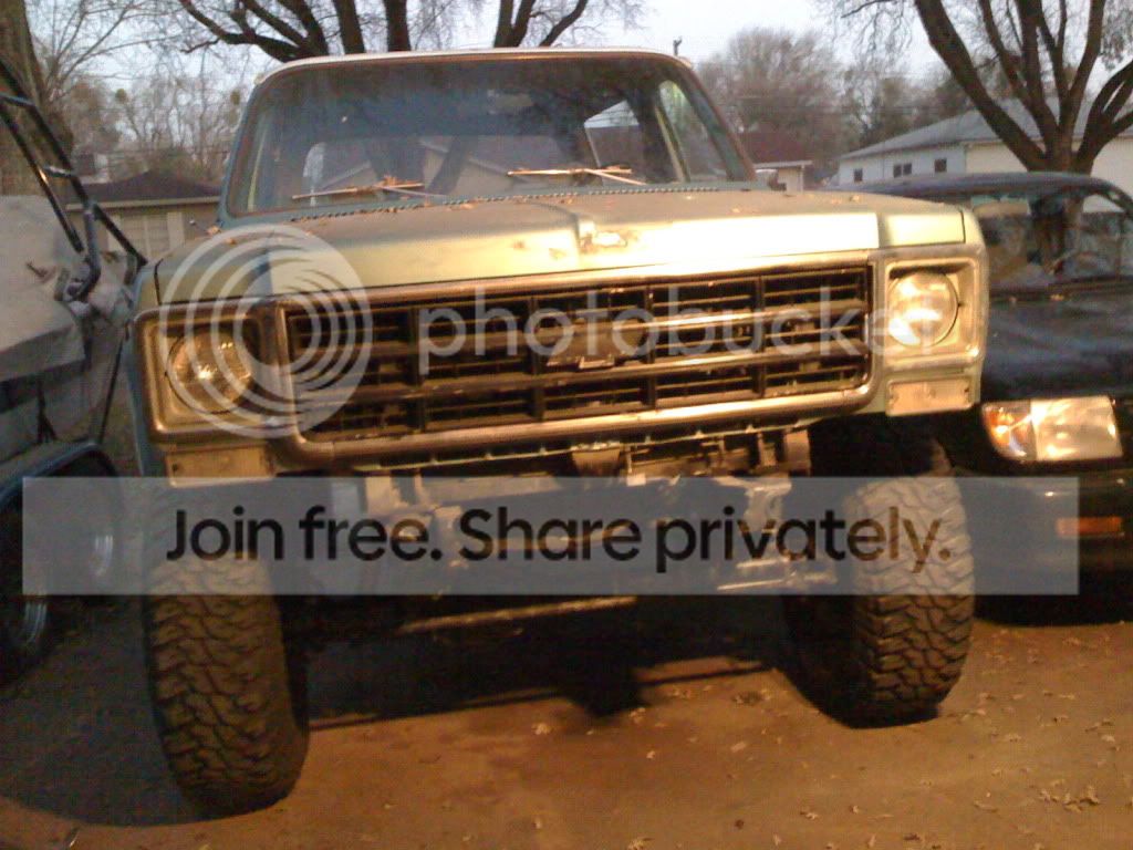

It wasnt long until I decided I wanted to wheel it. It was so hard cutting into such a beatiful truck, but there was a lil rust that needed some tending to. I slapped a 4'' lift and a 14 bolt on her and threw some 37" MT/Rs and went wheelin.
Don't hate me so much because the paint was not as good as it looked. It was peeling and flaking within the first month I had it. They didnt prep or use good paint.

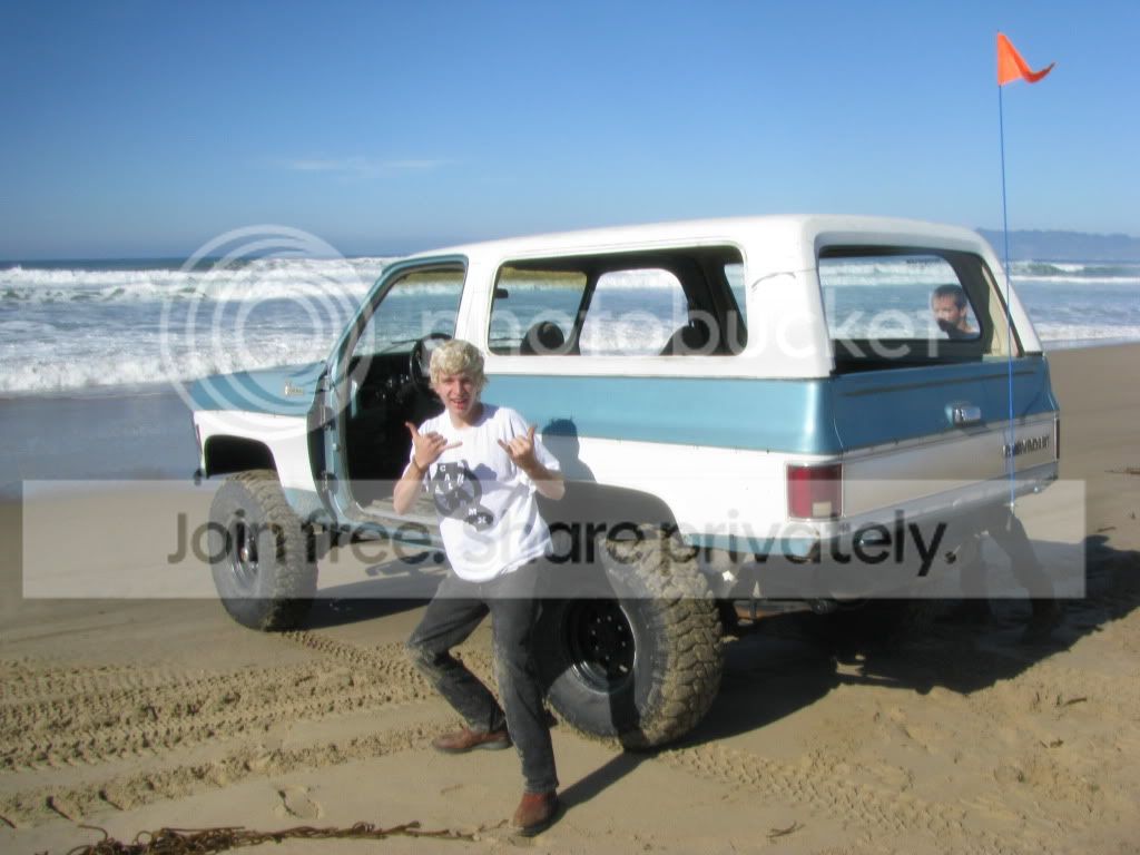

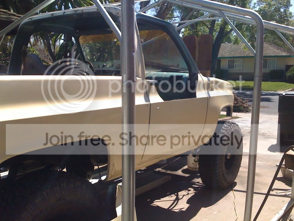

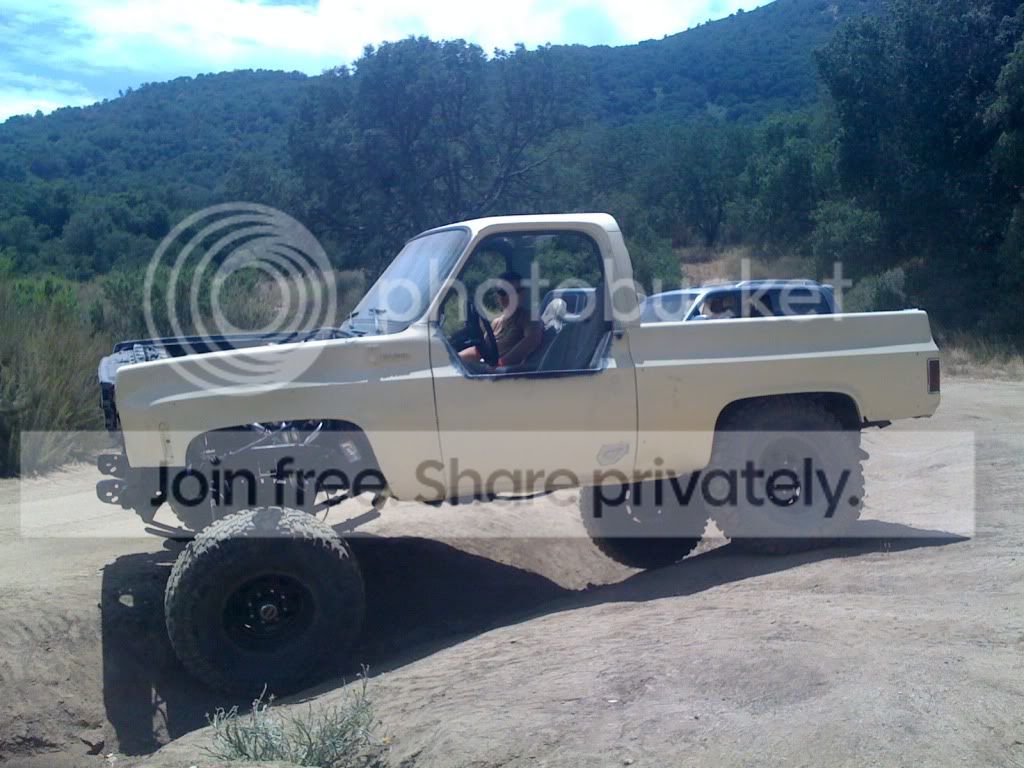

I wheeled it like that for awhile and soon got tired of the open diffs and excessive sheetmetal so I welded up the rear threw a shackle flip on the rear along with some 56" springs and started cutting...oh and doubler time!

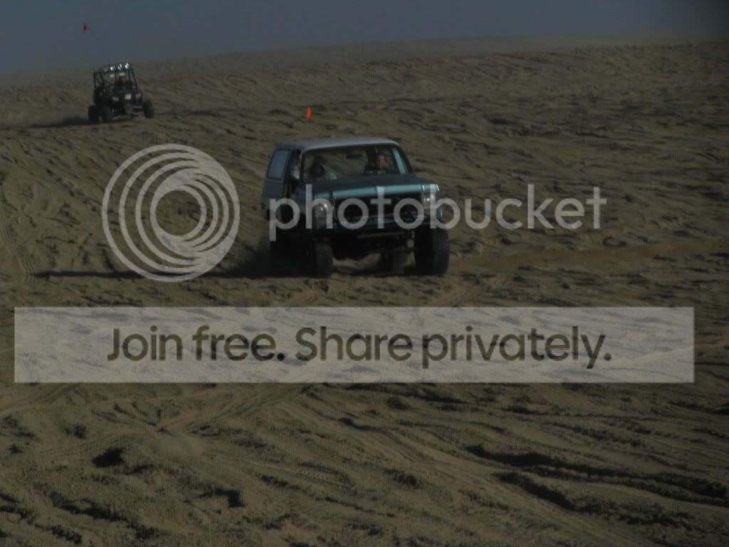

Pismo trip
Snip Snip

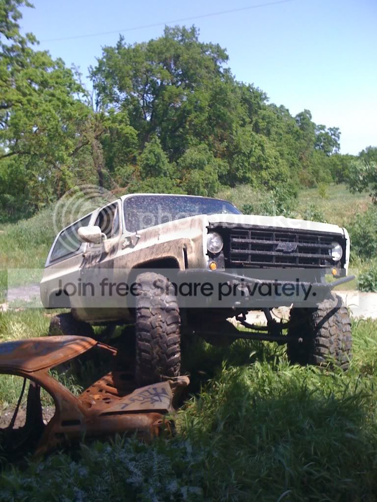

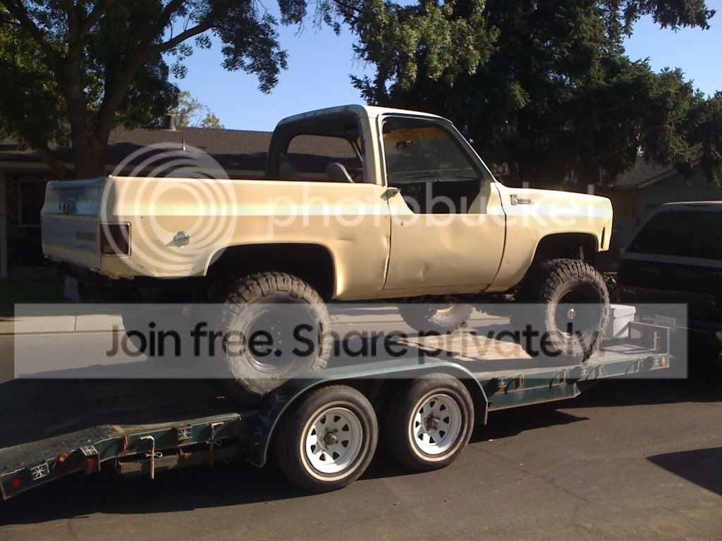

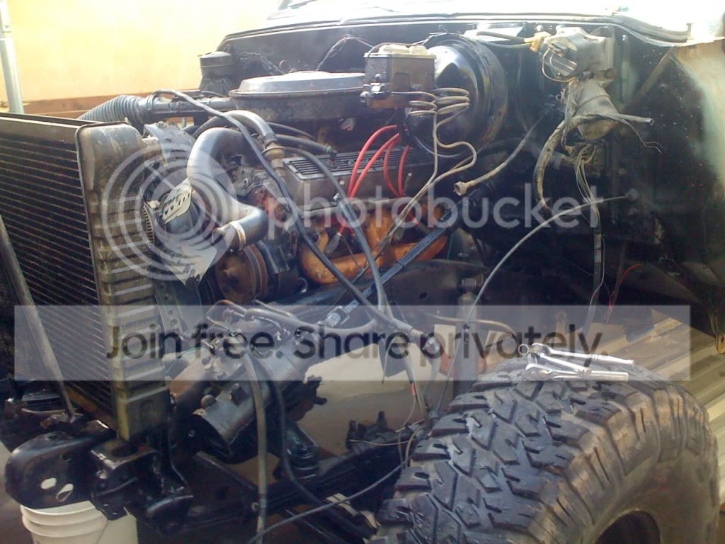

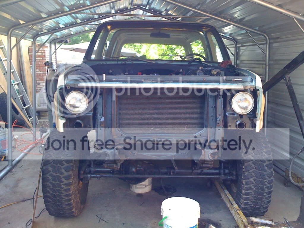

The 350 I had dropped in was getting tired and I wasn't having the bulky front end anymore so.... I bought a 91 tbi 350 and brought the front fender together.
All together I ended up cutting 6" out of each side of the core support

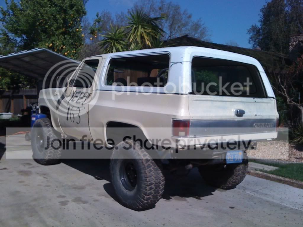

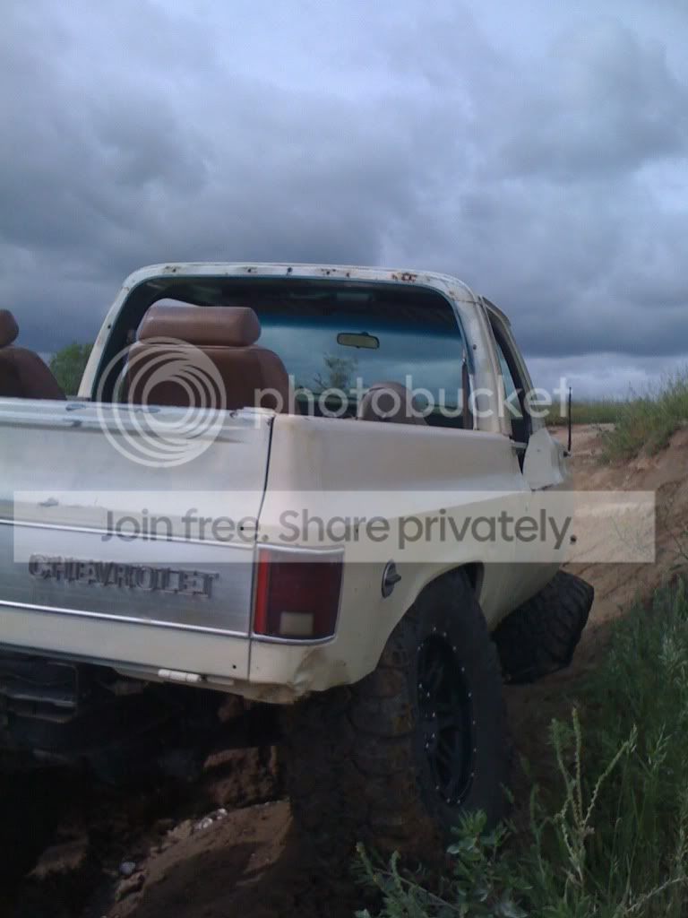

Well here she is ready for blazerfest 09
Bonanza Gulch
All in all Blazerfest was a blast and cant wait to do it again this summer

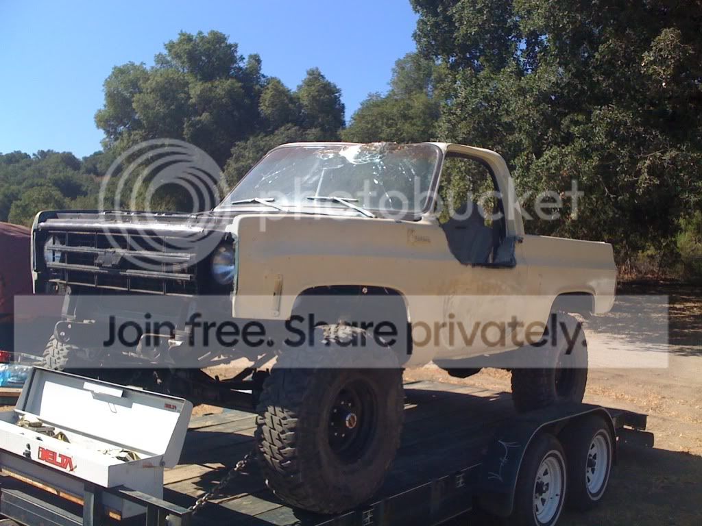

As for the windshield...Well... basically I thought I would fit under some over hanging roots and It didnt feel like fitting as soon as I backed out BAM! windshield.

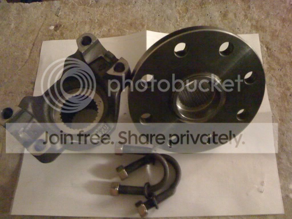

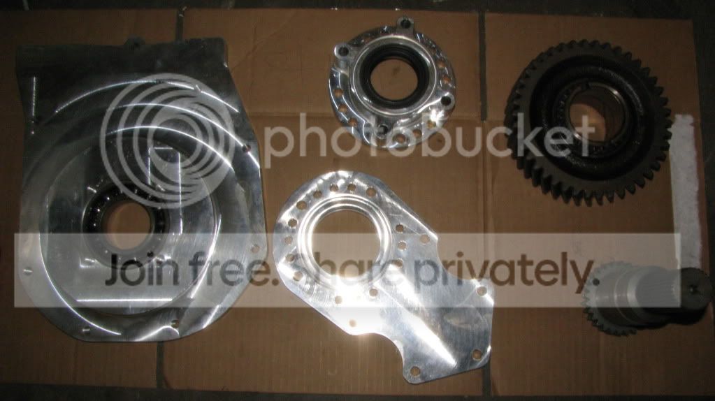

I scored a driveline with a 1350 cv and a 1410 yoke for 40 bucks!
So that means I have to buy a flange for the 205 and 1410 yoke for the 14 bolt:doah:
Its hard to keep a truck nice when your hanging out with this guy http://board.marlincrawler.com/index.php?topic=48229
I got some parts together...
1350 C/V Flange and 1410 yoke for the 14 bolt.
And got the beefcake of a rear driveline shortened.

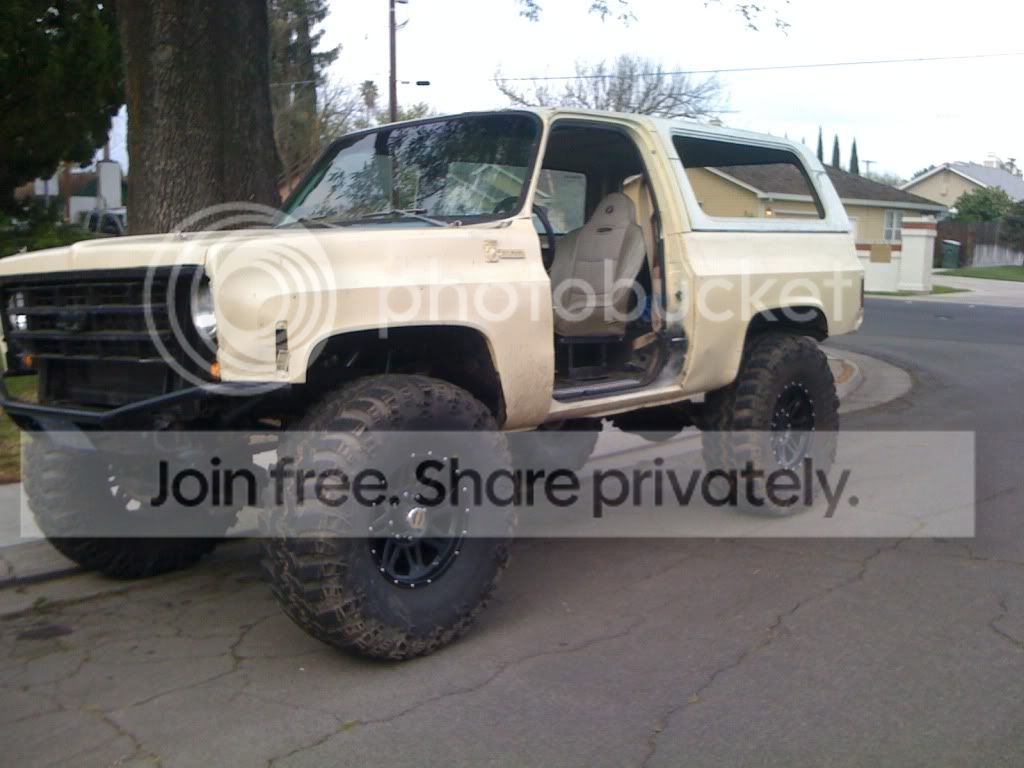

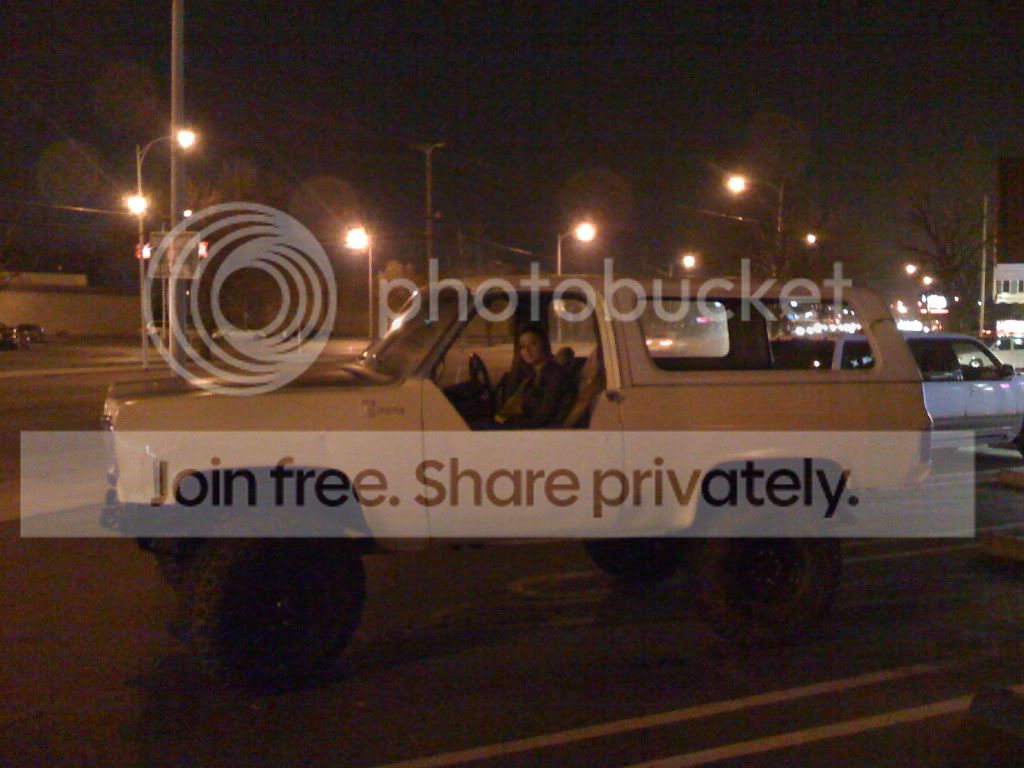

Heres how she is sittin lately... with some 41 Iroks and 18's I found on ebay for a decent deal. :draw:

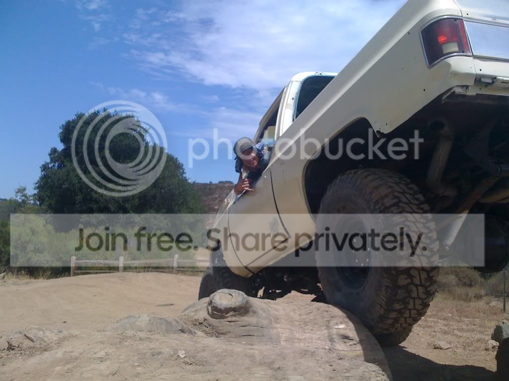

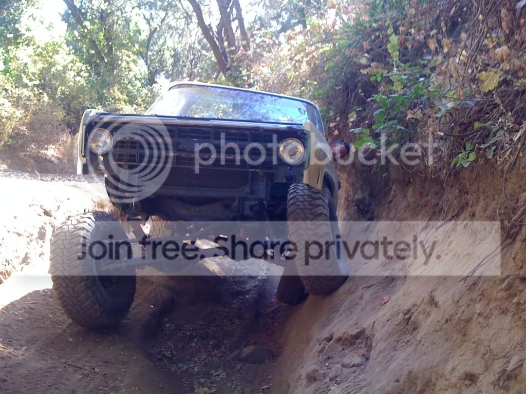

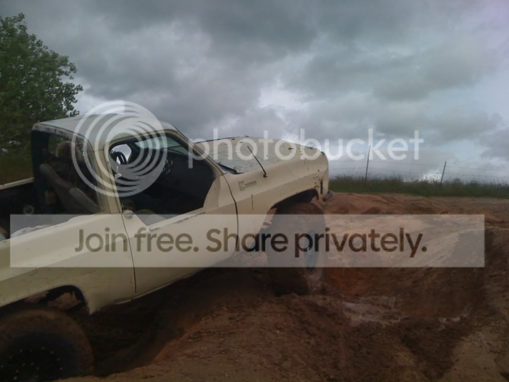

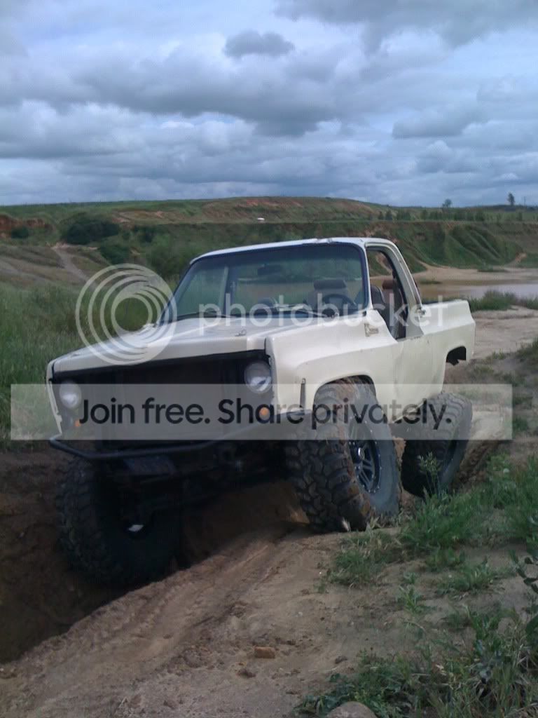

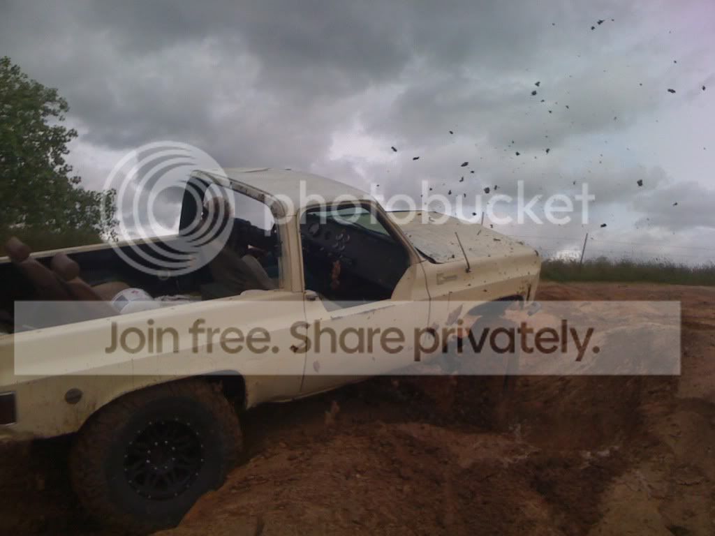

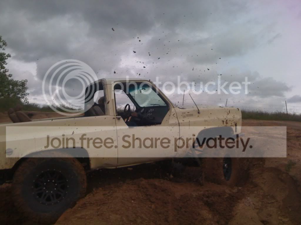

Been wheelin a little lately and found that I had some major rubbing issues between back tires and inner fenders so I ordered some 1.5" wheel spacers and got a couple pics...
Went to the local offroad park. It is amazing what little inches can do to the way a truck performs. 3" wider and stretched rear make the truck feel so much more stable. We had a good time for a short day run.
