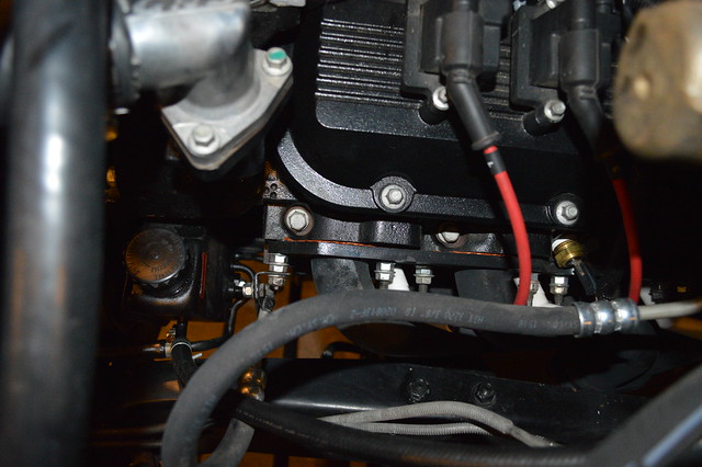

Regarding the temp gauge, you sure didn’t read hacking in to the coolant temp sensor wires to run the dash gauge in my threads because I would have told you there is another ½” pipe plug fitting in the drivers side cylinder head that an earlier BBC temperature sending units screws right into then plug your original dash wire into that…. :waytogo:
Cool thread….
so i tried takin mine out but it desitegrated!!!! spellin? lol
