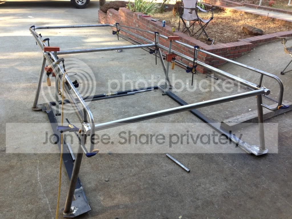

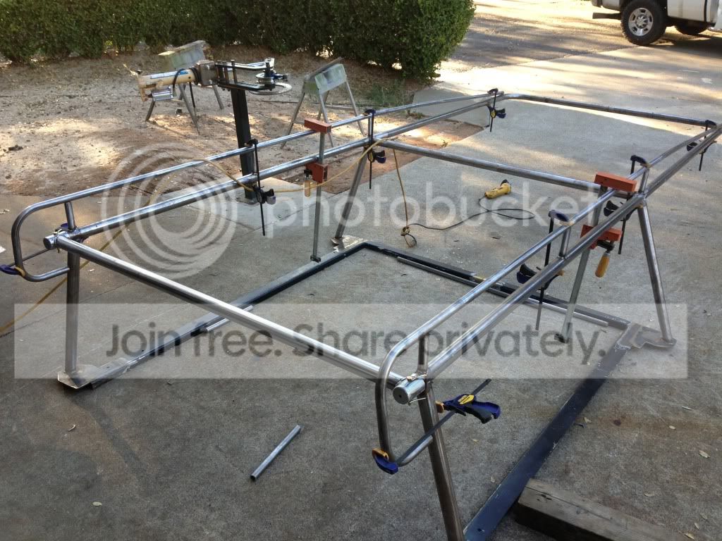

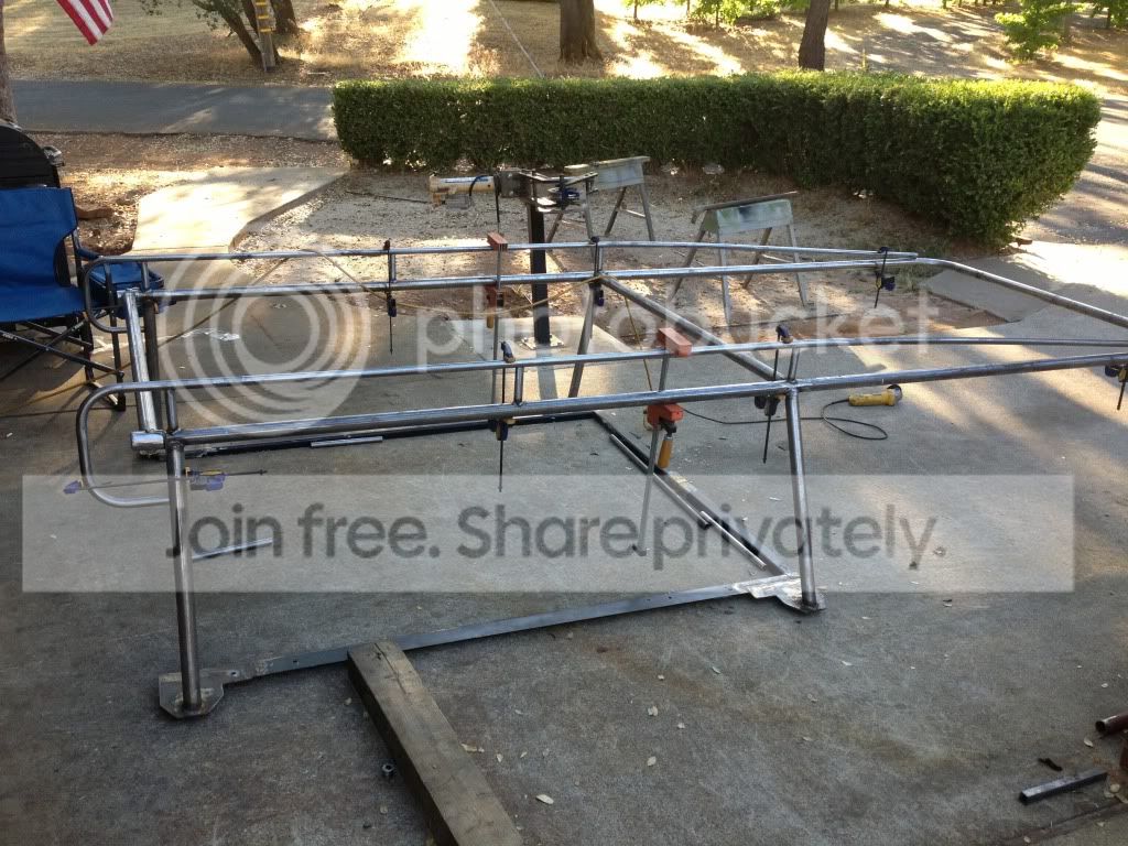

Here is one that I built for my partners rig. It's built for a shell. Originally the leg landing pads were 1/4". That proved to be too weak and were later cut off and entire bed rail wrap of 3/8" was used. We just welded the 1/4" pads on top of the new 3/8" landing pads. We were going to weld in some gussets after he bought a shell to go inside of the rack. Still to this day he has never bought the shell and I've never installed the gussets. Lol We load the crap out of this thing and it's never even shifted. Someday we will weld on some gussets. Until then, it's just an inside joke.
Everything is 1.75 HREW, with 1" top bar and 2.25 caps for the rear bar removal thingy.
Awesome thanks mike! Do you think 1/4 would be fine if it's just over the rails and not extended out for a cap. He doesn't have a cap and doesn't plan on buying one. He had a 16' enclosed trailer for that stuff.
Yep, plenty. If your going over the bed even thinner could work. But you know me.... I don't think I have ever used any 3/16". Lol
The biggest and coolest thing is to weld tie downs everywhere. Unlike any rack you buy, two over the windshield bar are awesome for tying down the long stuff. IIRC this is just under 12' from bar to bar and low as we could go over the cab. We couldn't get a mid bar over the cab roof if we wanted. It looks way cooler when you don't have 6" from top of cab to lower bar. I'll take one tomorrow when we head to work of what it looks like now.
