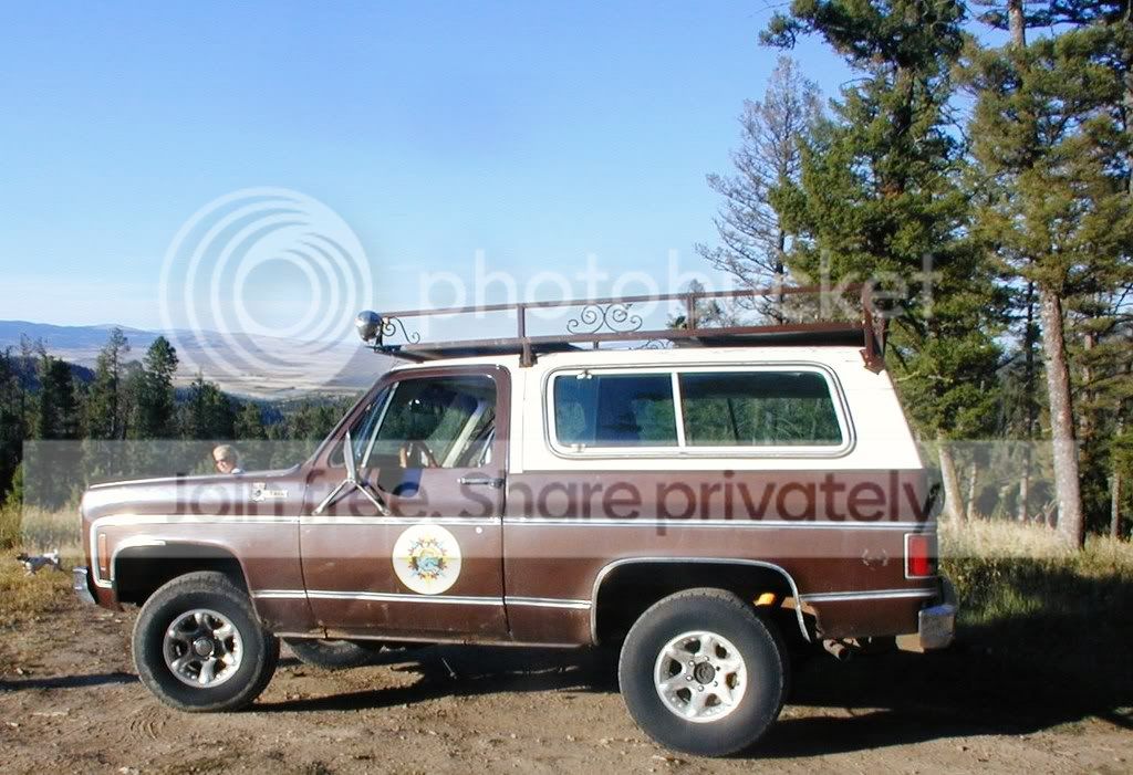

Anything is possible. I bought a 78 K5 with a roof rack and I climb all over it. It would EASILY handle such a ladder. Best of all, this looks like a "diy" made jobber if you have a welder. Here's a pic:
Mine has plywood on top but I would recommend using expanded metal. It bolts into the metal bows which supposedly exist at the front and the rear of the fiberglass top and easily supports 200+ lbs. Strapped down to the front bumper and the rear trailer hitch, I know this thing could easily carry a ladder like that. Heck, I did it on my Jeep Cherokee with a stock Jeep rack.
