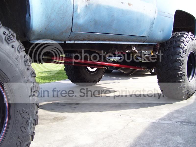

You could try a set-up like mine.
But with that kind of power, I would suggest using larger tubing than I did. and some actual rod ends.
(Yes half the welds look like ass.... they're fixed now)
A bar like that would work for an application like yours, for awhile. If you use your truck mostly as a Mud racer you run a higher risk of spinning u tube. i would feel better running a traditional dual ladder bar setup. You are limiting your suspension movement. But it's not as crucial in your application. You could 4 link it too.
Weld the tubes to the center section as mentioned in Avery's thread. Mine are already done in anticipation of the traction bar.
