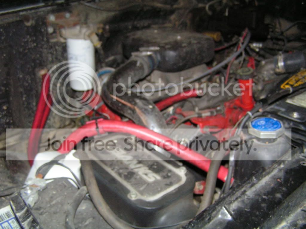

Thanks for the link..I think my stock filter base is the same thing as that # Wix unit or dam close...the 3418 Napa is the same as a 33418 Wix and I'm pretty sure thats the number that crossed over to the Detroit Diesel filters I can get cheap...if that one clears your turbo I'm sure I'll have no issues with clearance..
