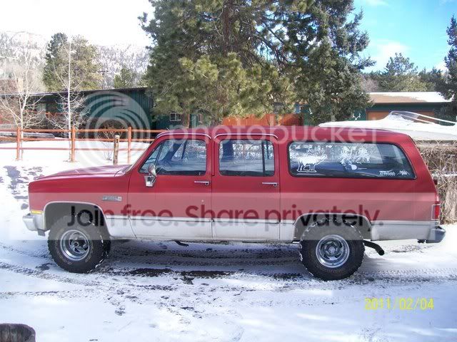

I put 33x12.50r15s mounted on 15x10 rims with 4.5" bs today and had to remove my running boards.......they rub the fenders during a hard turn Left or Right if there's any suspension travel up at all. I'll be driving easy for a week until we get the 4" lift on.....:D
BEFORE with 31s and running boards:
AFTER with 33s and NO running boards:
