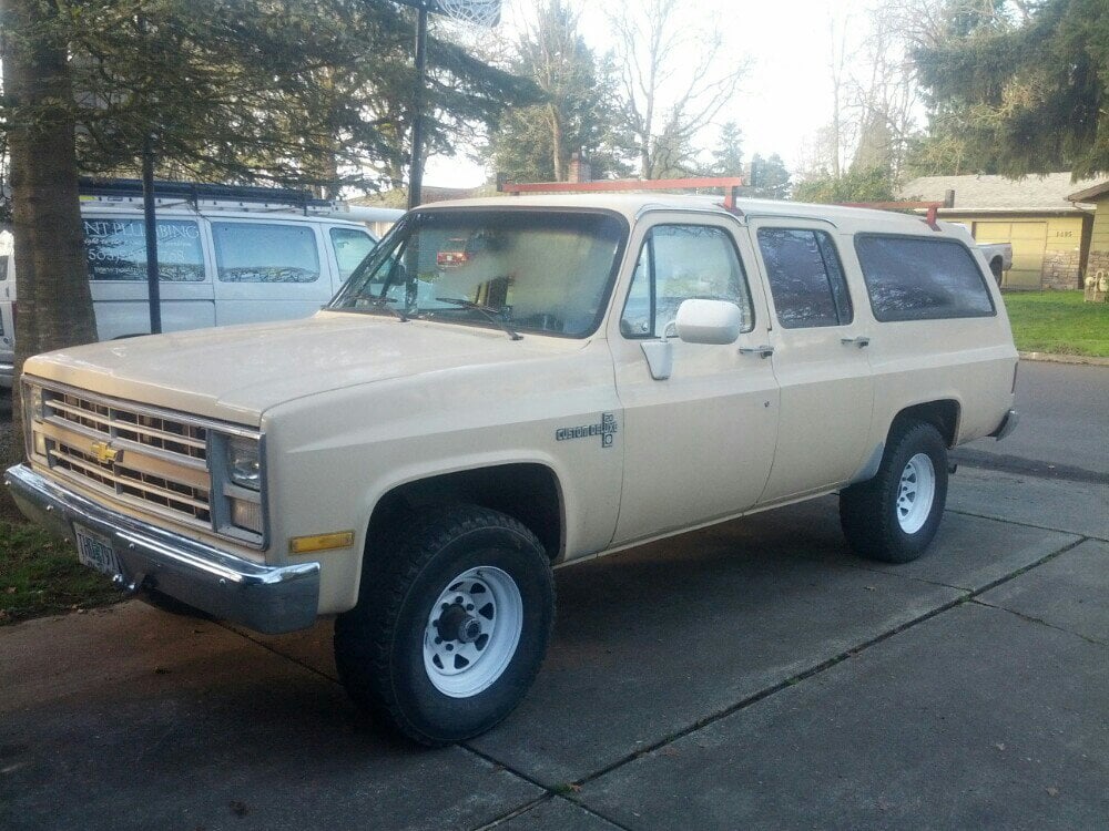

33s on wagon wheels, no lift, no rubbing but its a work rig currently
My CUCV when I had it had 33s 9.5? Stock height, didn't rub street or off road. Swaybar off
My 82 I have right now, 33s, 9.5 stock height, doesn't rub street or off road. Swaybar attached.
Now, both diesels, not sure the difference in springs as far as off roading goes for rubbing. And never checked to see if they were actually 33s, or closer to 32s.
I have stock hight 80 with 33/12.50 with 3.5 backspace it only rubs a little at the rear of the fender just before full lock but only when turning to the right
