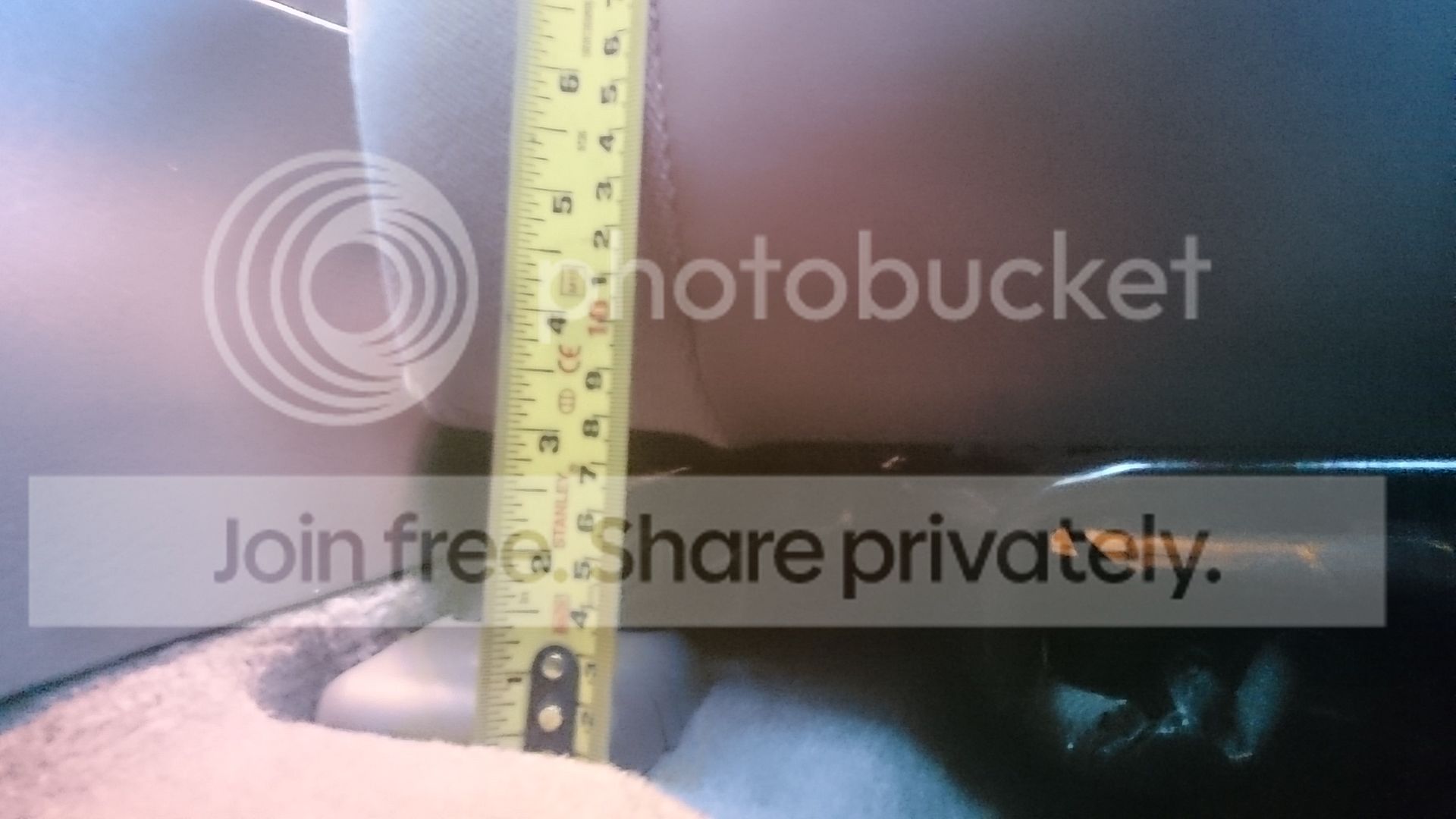

I have a 03 trailblazer here with full power seats and an 05 with the basic manual seats if anyone needs/wants some quick pictures or measurements.

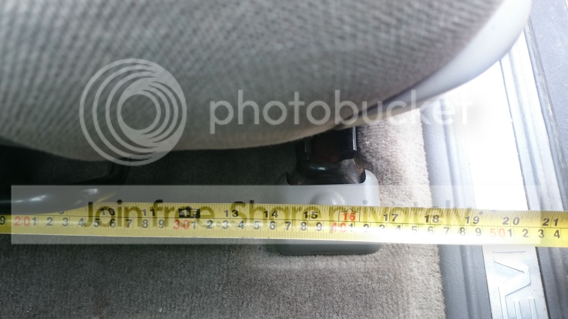

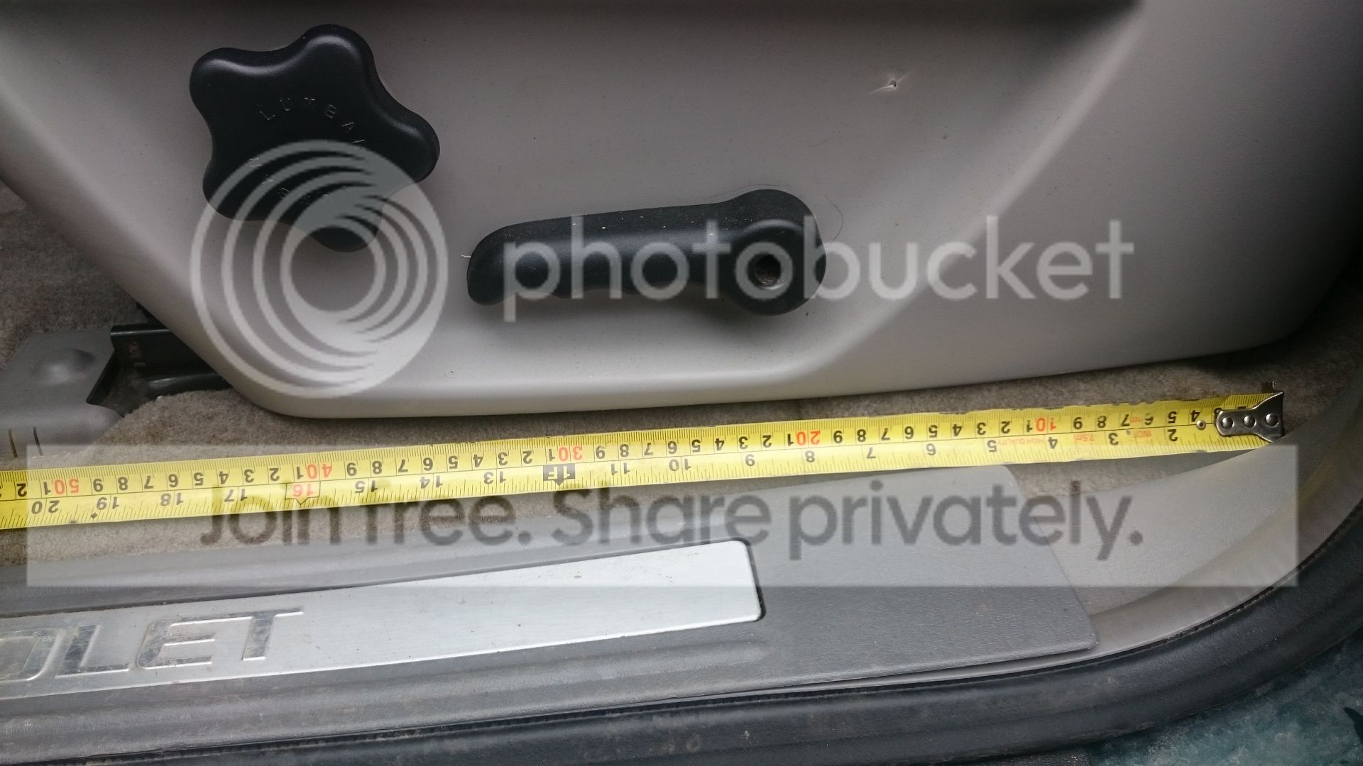

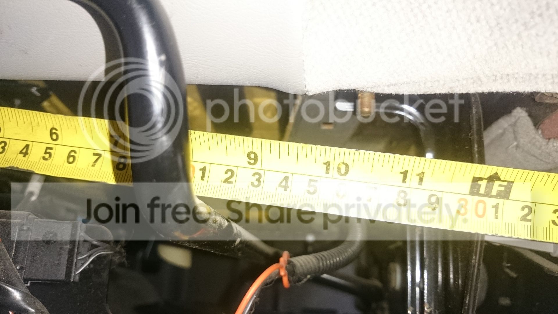

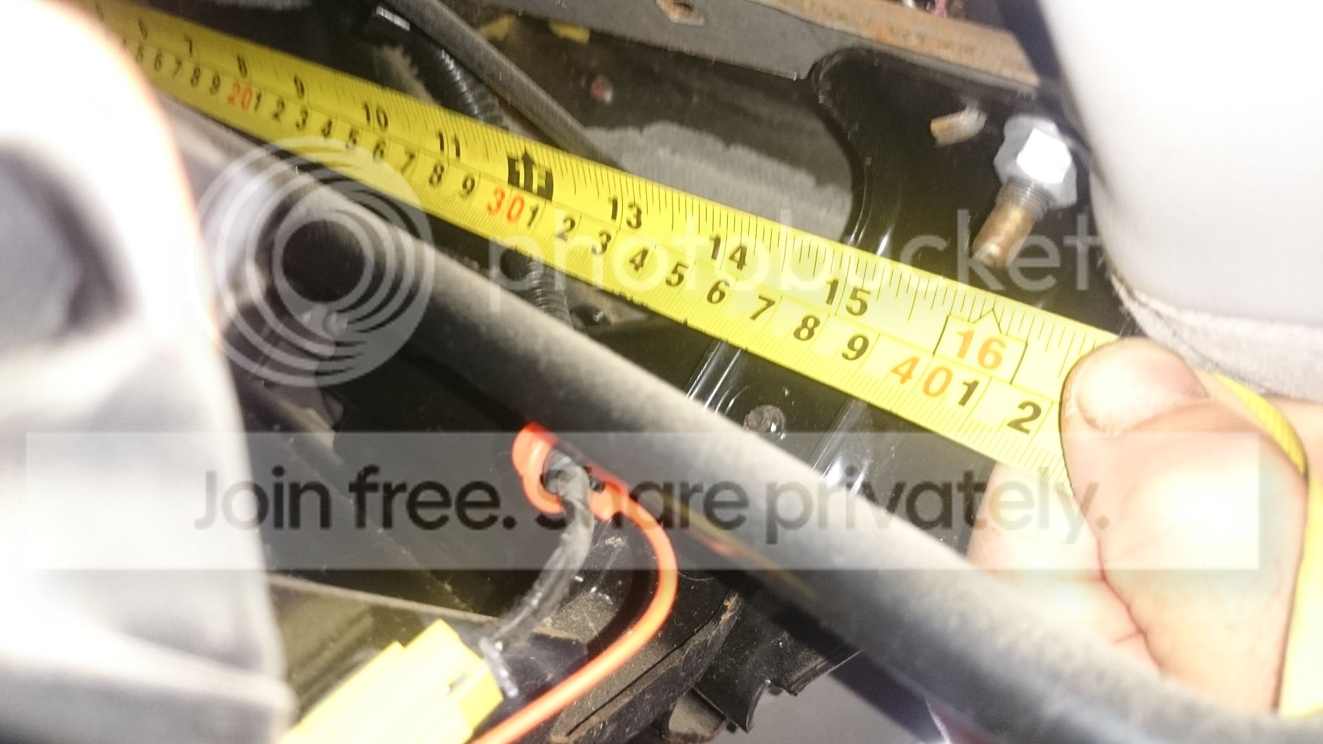

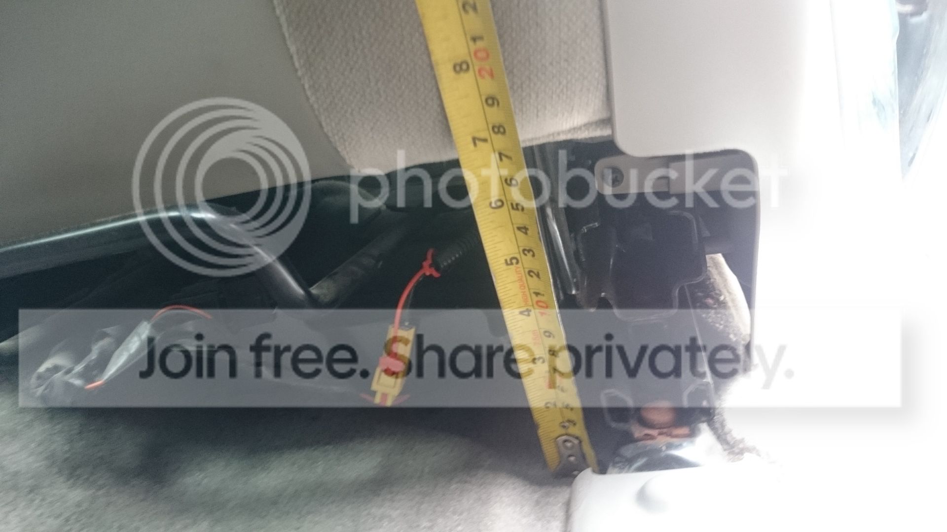

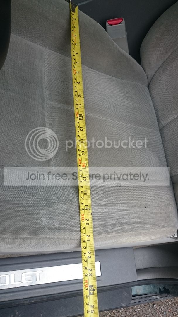

I'll take as many pics and measurements as you can get. Mostly it about the base size and height.
Lower frame length
Width
Seat frame length
Width
Seat frame height on the outside
Inside
Seat width

I really appreciate the pictures and measurements. I've had a "full plate" these last few days, and I haven't had time to think about seats. I'll compare your measurements with my stock seats to see how it will compare. You said the seats in your pics are 2005 Trailblazer (manual adjustment) seats, right?
Yes the pics are from the manual adjustment seats in my 05. The 03 full power, heated leather seats measured the same.
I also edited the other post with the picture of the inside frame height.
