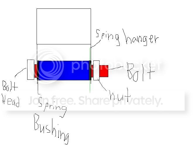

    ok here is what I think you are looking at. sorry for bad drawing
    Why dont you cut the bushing and the bolt that way you wont ruen the spring just need a new bushing. I would cut on both sides were the green line is
    [​IMG]

    well, that would work except it's the drivers side and i have a strap on the front of the shackle. I'm not to sure what years they did that but my first gen has a piece of steel(from the factory) welded to the front of the shackle. I cant get anything in there to cut it.

    I just had the same problem with my "79 K20. I took my 4" angle grinder w/a cutoff wheel and cut the bolt between the bushings and the ear on the spring mount. With a new wheel I had just enough to cut through the front eye bolts.As far as the strap goes cut into it as the cutoff wheel cuts the bolt. If it needs to be, weld up the cut in the strap.
