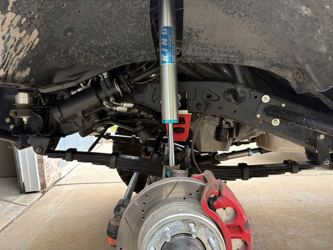

Leafs settling or bent?

Was rotating my tires yesterday and got a good view of the shape of my driver side leaf spring after Blazer bash. Is this normal? If so should I expect it to settle out? Or is this something I should be concerned with? I have texted a few friends and their opinions range from: "You are fine" / " If its bent like that it could snap at any time".
No. Hit that spring with a hammer, on the side. Listening for dead sounding steel. You may have a broken leaf in that stack.
