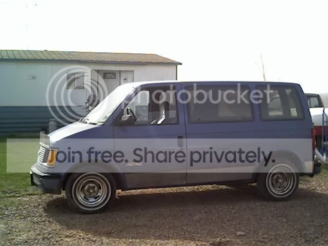

My 97 GMC is my current daily driver and has 230+k miles on it and its worn out sad and COMMON. I have always been the kind of guy to want something differnt than everybody else. SO Im going to build myself a new daily driver. I also have a 94 GMC light 2500 with a bad 350 and a new 4L60E and a NP241. I want to rebuild the 350, then rob it the trans and transfer case and the computer and harness. It will then all be put in this.
Not everyones cup of tea but I like to be differnt. It will then get a 5" weld in sub frame lift and a 6" SAS. I would like to make the D44 6 lug and match the studs with the metric 14BSF out of the 94.

That's great that you are thinking outside of the box. I always like to see something different as long as it done well and you can have some fun with it. I think you could call it the Shaggin' Wagon or Mystery Machine if you have a build thread.
