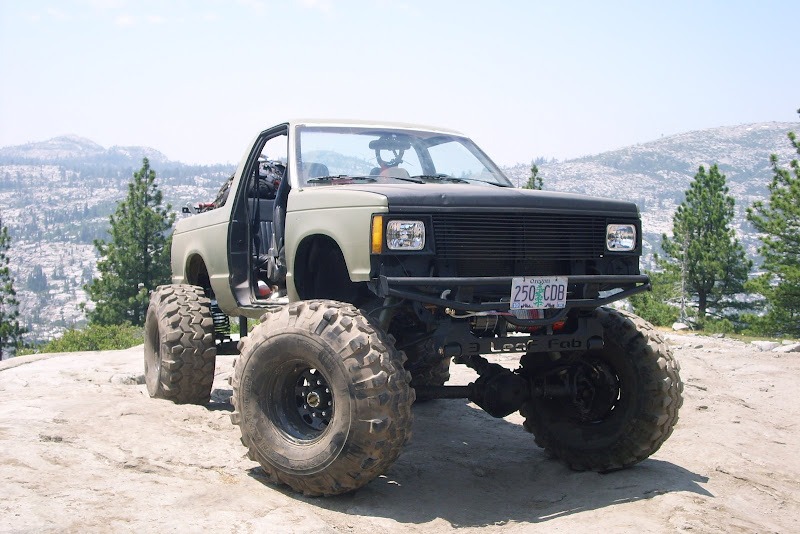

ok, i have a legitamate question on getting a d60 or upgrading my d44.
my rig is an s10 blazer with full width 3/4t axles and 38.5 TSL's. its running about 3500 lbs empty or more like 4k loaded with tools and camping gear. im not pushing a high horse motor, but i do have about 20k ft/lbs at the wheels due to my gear reductions. i know on a full size, this would be pushing the limits of the d44 and most would say just get a d60. my axle survived a week trip at the rubicon, but i feel like i need to baby it. now dont get me wrong, i generally am not a throttle jockey but i do like some peace of mind. but im not sold on the extra weight and clearance (or lack there of) of the 60, and it might truly be overkill for me.
lets say hypothetically that i have a $1k budget for front axle upgrades in the future. do i look for a 78-79 HP60 or do get the works on the d44? i've heard it said that a built 44 is similar to a stock 60 in strength, but the thing is, with a built 44 there is warranties on the parts that i am likely to break. there is also a thing i read about 30 spline stubs for 44's now.
i would need to get at least one high steer arm for the d60 if i went that route, so i would be limited on what i could get with a d60. i could potentially get a lot more bang for the buck with a build 44 considering i already have the housing, steering, locker, and gears.
so does anyone have any real world experience with something similar to this?
