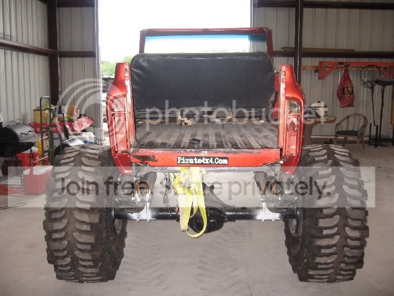

5", gobs of trimming, Axles moved fore and aft, no inner fenders, Dovetailed front and rear.

Nah, no swooping or thunder stealin' here. Just pic whorin' :haha: .

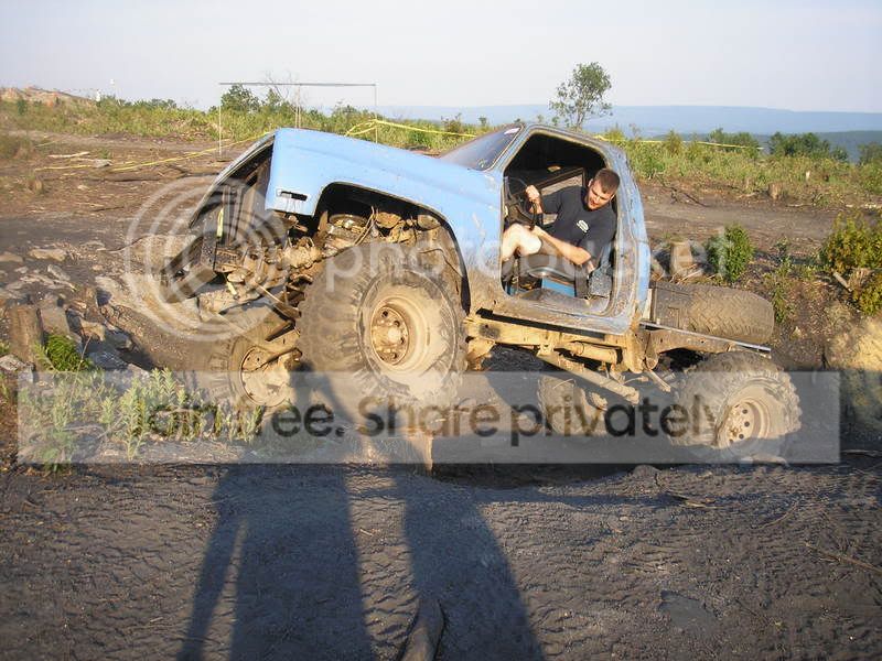

8 inches between BDS springs, ORD reverse shackles, Hill4x4 front shackles, and ORD zero-rates....no trimming, 44"s but only temporary cuz they were cheap....i put them on to see how it would look before i sold them...they rubbed when i turned or hit any sized bump...it looked good sitting there tho...back to 38.5's now...

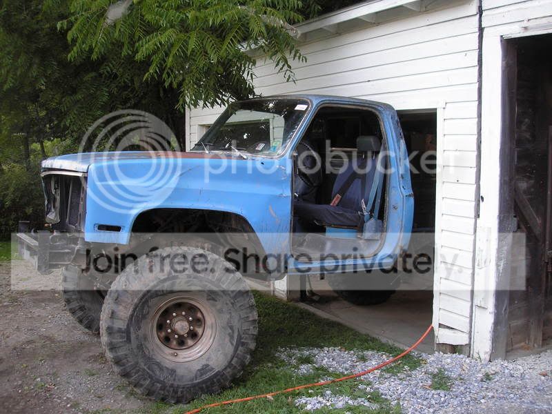

8" superlift springs and a 3" body lift. bushwacker cut out fender flares.
I removed the bed and dropped the bodylift down to 2" also bolted on some new fenders with a nicer looking cut. fender flares don't last when you actually wheel them.
