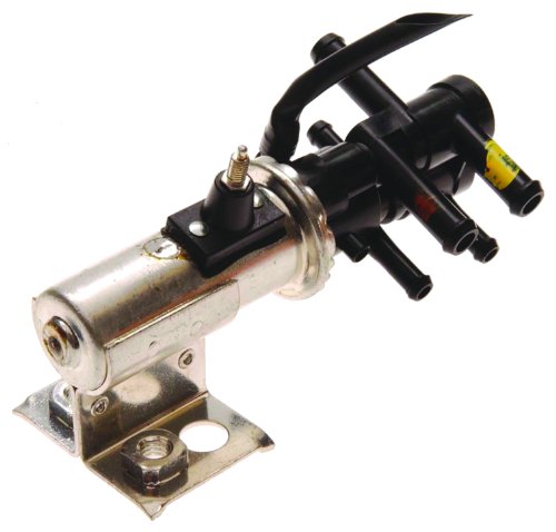

Standard Motor Products FV1T Fuel Selector Valve
3.6 out of 5 stars 19
$33.89 Prime
7 used and new from $33.62
I do have a dual tank selector valve and going to use it; however, the issue comes IF and ONLY IF I do an LS or 8.1L swap with high pressure. these are not rated for high pressure....
I have this one.. 1 wire.. 1 fuel 1 vent per side...
