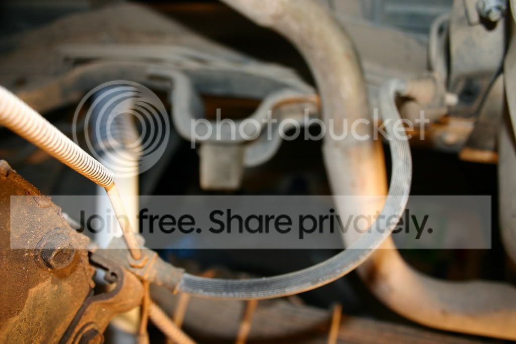

Hi, Kert. No, nothing is tight, at least while it's sitting still there's a little line left. I do have my black widow brake lines sitting here waiting to be installed, just didn't have the energy to do 'em tonight. I can't see anything that looks like a valve to me, but I'll post a pic in a few minutes soon as I'm done putting my gas tank skid plate back up.
Nope, mine looks like this:
Sorry for the fuzziness. It's just a pass through hanger thingy up there. Any ideas what else it could be?
sounds like the rotors are warped then. Maybe it is more noticeable now that you have bigger tires on it, and they are working harder. :dunno:
