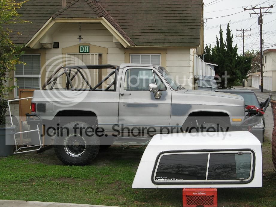

This is what I'm talking about. I have the 4" flip and zerorate 1.5" back. You can see my 38"s sit nice in the wheel well. This truck has 7 leaf 3/4 ton springs and I will NOT be towing with it, far too soft and soggy in the turns.
