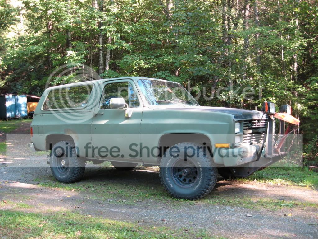

I drove a M1008 with 35s and no lift. Not much trimming either. I am driving a M1009 right now with 33s and no lift, no trimming.
