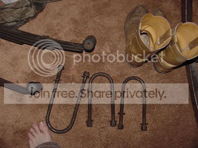

Is it ok reuse the stock spring plates off my front corp 10? I have 3 of the u bolts and nuts I need, but one fell out during shipping, so where can I get another one (one of the longer ones is missing)? What size are the front and rear spring eye bolts? will I need washers for the spring eyes?

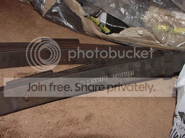

Does anybody know the extended and compressed length shock I will need for 4" RC springs with 1" zero rates, not moving the axle foward and using ford shock towers?

I just need to know where to buy one of the longer u bolts for a 3/4 ton corp 10.

you can see which u bolt is missing, any part numbers for it?
the zero rate is set to move the spring foward 1", so I'll need to move it back to the middle position. How much torque will I need to put on the spring pins? any tips/ directions for setting this zero rate up back for the stock axle location?
I guess I can just look at how the zero rates are set up, and figure out what is the front of the springs. There aren't LEFT or RIGHT springs though, right? Either will work on either side of the truck?
there is no left or right. The smaller eye goes to the rear shackle, bigger eye to the front hanger. It is ok to use the spring plates, but if it was me id get new u-bolts made up
I had a major brain fart. I need another short u bolt, like two of them in the pic. I wonder If the long Stock u bolt would work, but reusing 30 year old u botls is probably a BIG NONO, I was gonna reuse these 3 ubolts in the pic, beucase they were just on a guy's truck for a short while. Maybe I can find one of the shorter u bolts, like in the pic at a auto parts store?

I would just get new u-bolts all around. I got mine from summit, kind of pricey. I think you can get them at your local napa store too.

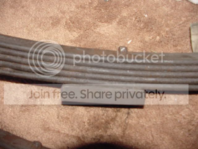

another thought, would I lose alot of lift If I took the bottom leaf out of these springs? I don't want it to rattle my teeth out.

I wouldn't fool with used u-bolts, get a new set from rough country, not that expensive.
i think the front are 9/16x6" and the rear are 7/16x5-1/2? thats without having the truck here just off memory, as for the u-bolts most any semi-repair shop can bend them up for ya, just take one of the old ones and have them make you a new one, should be less than 10bucks
