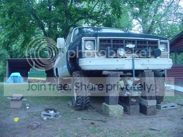

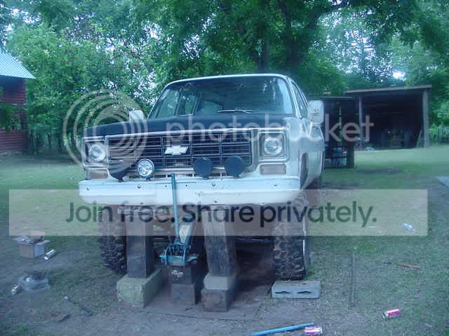

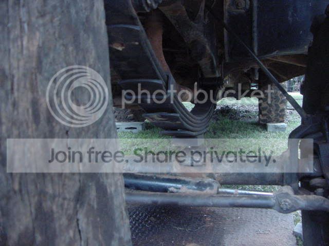

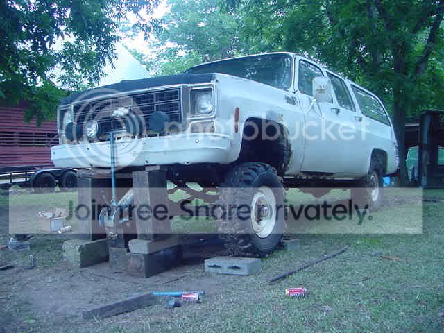

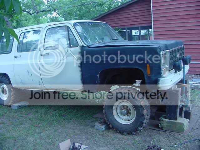

well, I woke up this morning refreshed and ready to work. My buddy wasn't over yet, but I was able to jack the front of the truck up enough to bolt in both front springs. Then after I had taken these pics we were able to wrestle it around enough to let the center pins start to sit on the holes in the perches, and I now just have to put the u bolts on. I have one u bolt through each spring plate. I'm trying to reuse the u bolts because they have low miles on them, but they are kinda hard to line up through the spring plate holes. I did have one of them made at the spring shop, and I'm considering getting them to make the other 3 from scratch too.
I also noticed that the hole in the spring perch is about the same size as the bottom of my 3/8" center pin. I suppose the soft metal on the pin will be forced into that hole when I torque the u bolts down?
Anyway, I've made encouraging progess today, and I'm well on the way to being done with the front of the lift.
Isn't that the most beautiful death trap you've ever seen :eek1: :waytogo:
