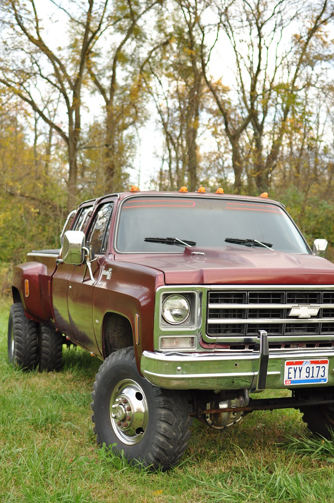

Are you opposed to a bias ply? I love my 9.0x16's, there's a 2 inch spacer on the rear, but they don't stick out past the fenders. I've given the spacers a lot of stress, no issues.
*edit* OK, I guess they stick past the fenders a little bit.
That's exactly what I was looking for. What kinda spacers do you have and what's the name of those tires. I couldn't figure out what they were called
Truck looks good USSkoval. Kinda look like like a Ground Hawg. His Sig line says 9.00-16 Power Kings
