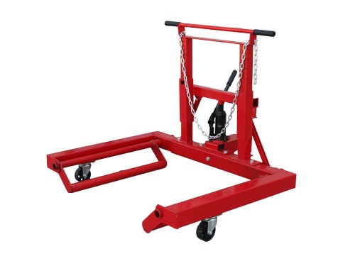

Me getting old too. I got one of these tire dolly's for my 39.5" TSL tires. It works great.
http://www.princessauto.com/en/detail/torin-big-red-trade-150-lb-wheel-dolly/A-p8536062e
At my old job they did a lot of work on medium and heavy duty trucks and several of these around. An experienced mechanic could quickly and easily get a 22.5 semi truck on the studs. For even heavier stuff like Super Singles they had a wheel dolly like this.
Same concept as the above tool but just taking it to another step.

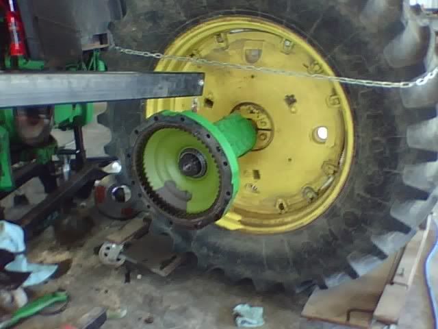

This device is not for lifting tires. That picture is misleading. That is for spliting tractor axles. No on uses it like it is shown in this picture.
images
Martin
This isn't a great picture, but this is the only one I could quickly find from when I use to work on tractors regularly. I am using on of those jacks in this picture.
