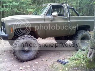

I have a friend that had a 81 Chevy that ran 39's on a 12" lift with uncut fenders. It was a little tall but had a nice look and didn't rub the fenders. Imo, anything bigger than 39's with virgin fenders will require trimming or a body lift, even with a 12" lift.
