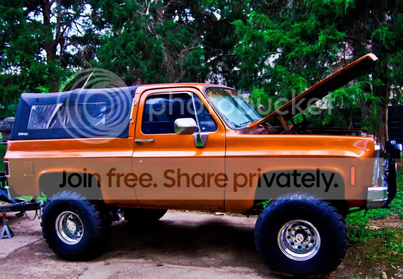

What size rims , sweet K5 !!!!!
4" inch rough country lift
36x14 ground hawg's with trimming/bending.
