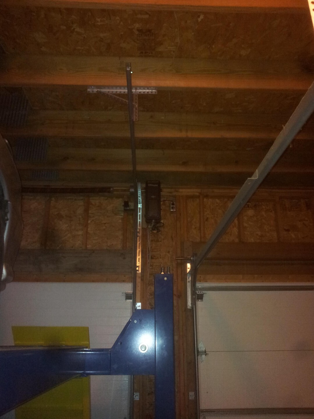

I installed one of these jackshaft openers to accommodate my high lift garage door which I high-lifted because of the lift I installed in there.
These things are really nice. Mounts to a couple 2-3 inches of torsion bar sticking out past your end plate. Super quiet, super compact, strong, easy to install and adjust. No mess hanging down in the middle of the bay, no belts or long chains to drip and adjust constantly. I'll give them this, these are truly a innovative design.

The Jackshaft version they sell now is the 8500. I bought the 3800, which liftmaster stopped making about a year ago but is the exact same model without the "new" security 2.0+ stupid stuff that doesn't work with anything existing. I already had another door with it's opener (an older liftmaster), I have a homelink vehicle and an existing keyless pad outside, and 3 other remotes in other vehicles... I didn't want to re-purchase all of that, so I found a 3800 online new in the box. It works just fine with the "older" stuff.
But, the jackshaft opener itself, works awesome. Exactly what I needed to fit the lift bay.
