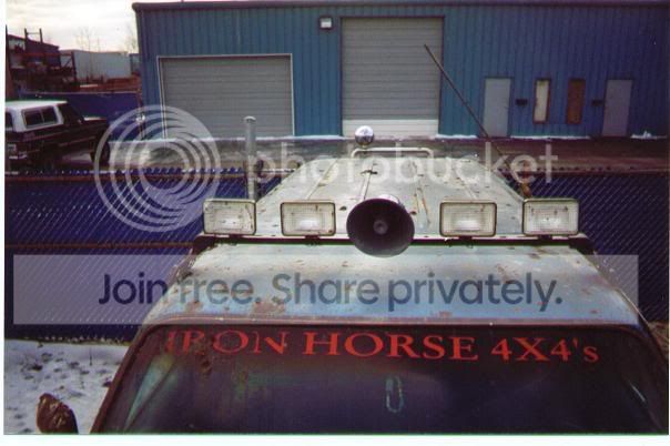

i put one on a old suburban i had. pretty simple they pretty much clamp down on the rain gaurd, pretty easy. you just have to cut them to fit. then you pry down on the clamps and tighten them with a allen key.
sounds like it and 4 hellas are the plan, how did you guys route your wireing?
i had one on my old grey truck, i just drilled a hole in the roof and ran it down the rear door pillar, and siliconed around the wiring, but some ppl are scared of drilling into their trucks, ive seen it going in through the doors and in the rear window on trucks, they put a weatherpak connector in for easy removal
the PO had a hole drilled that came down almost directly above the dome light. And then ran the wires all the way around down the plastic trim just ahead of the removable top .

the way i wired it was i connected all the lights to one of those trailer quick connects for the tail lights and i just run it through my rear sliding window that way i can just disconnect it when it rains or if i just want to take the bar off
