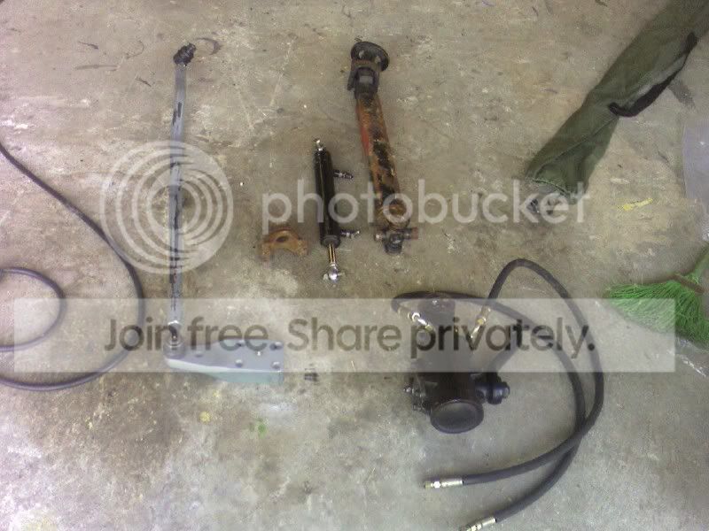

Parts I have been collecting
sky cross over arm and draglink w/ studs
2wd box tapped for hydro assist
Rocklogic 1.5" x 8" ram and wto hydro lines

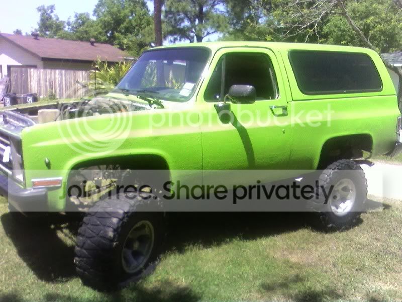

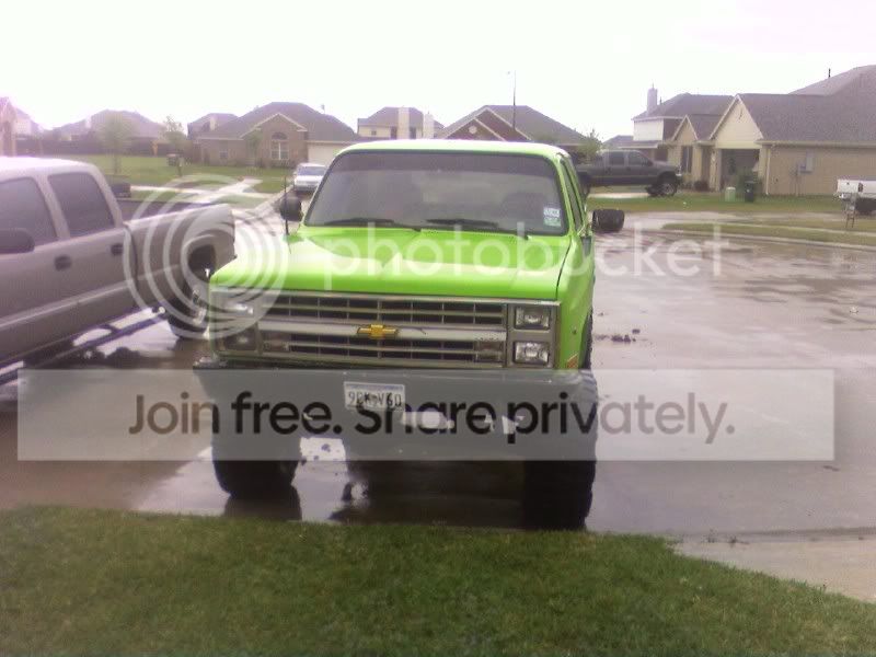

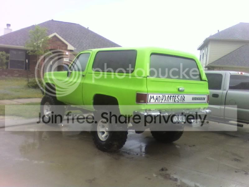

Here she is...
Well i went and paid for it this morning and have a clean title in my hand. It was pouring down when I paid for it so we left and came back when it let up a little. We pushe dit out of the yard and pooped the hood. The seller made a interesting comment about tryin to jump it and drive it home.. SO we tried it. I used a induction spark tool and conifrmed spark. Well then we chaecked fuel.. No fuel and the pumps not running my money is going towards the fuel pump relay or associated wiring. Well it strted pouring so we left and went and got a nice jump box we use for heavy equip. and the universal fuel pump of my 83. I start looking for a rubber line to tap into and discover that isnt one. The whole fuel system fron to back is either hardline or stainless steel braided lines with crimped fittings. So no luck on that idea. About that time it started getting real bad out so we left it until we can mess with it tommrow.
O y and heres some pics...

I think its gonna be kinda hard to hide from anyone now..
Ok so a small update. Its now runs and drives. The fuel pump relay was bad. I dont have reverse ,but it did before it was parked 2 weeks ago tho so thats a new issue to look into. ALso after i had drove it the 10 blocks home i rembered the radiator was empty. Luckily it didnt heat up enough to cause any damage. I filled up the raditor and colloant just flows out the block on the passanger side above the starter. My best guess is that it blew a frezee plug so it looks like ill be pulling the engine tommrow to replace the frezee plugs. Also the rearend is shot, it makes a horrbile noise so it now looks like the 1ton swap will have to done immediately...SWeet!

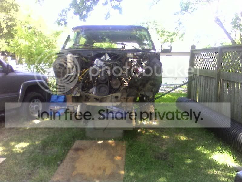

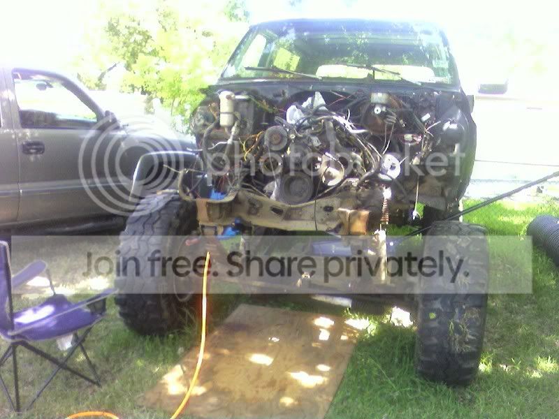

Well I pulled the motor last week to change out the freeze plaugs for a new brass set. The rear one behind the starer did infact have a rust hole in it. I figured since I had already gone this far i might as well do a little maintanice. For a lil extra insurance I replaced the water pump, oil pump and screen filter, timing chain for a Cloyes double roller,and replaced valve cover and exhast manifold gaskets. I also, popped a main and rod cap off to get an idea of the engine's condition. The bearings were in decent shape but, it appears the previous re builder didnt keep everything super clean and got a pice of grit under the #3 main bearing. Since I plan to do a 6.0 or 5.3 swap later this year i skipped the bearings and called it good.
I

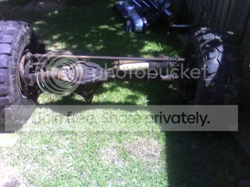

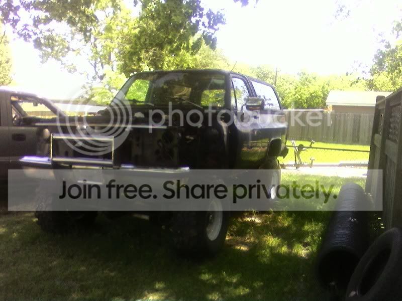

had I had a a day off this past thusday so I made a bit of progress. Pulled the front clip and d60 out of the donor rig along with the front springs, drive shaft, shocks and s.s braided brake lines. Then I pulled the 10 bolt , and steering system out of the new blazer to prep for the tapped and ported box. I got the cross over on and changed the oil in the 60 as well as removed the dual stabilizers and did a quick check of the internals. I ran a pattern on the gears and they seemed to be fine but, the entire carrier was cover in surface rust.. I assume its from the watery milkshake i found in the diff.

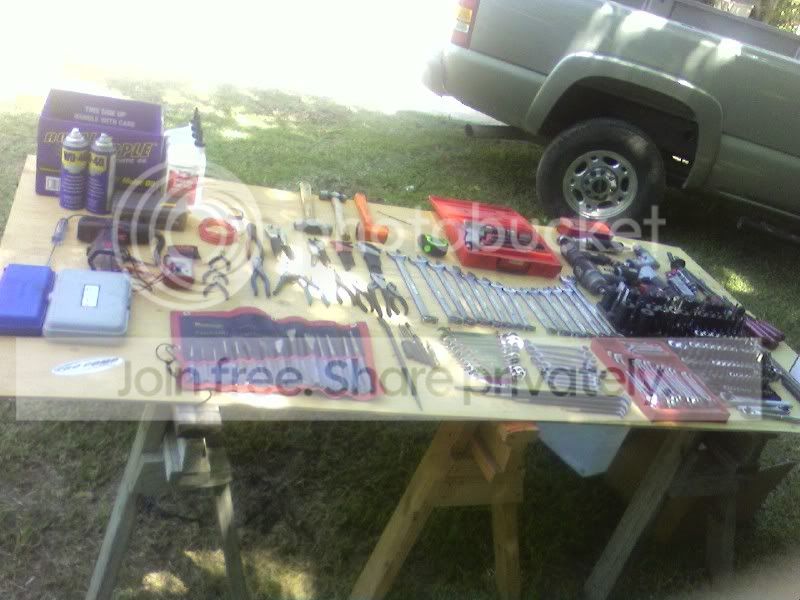

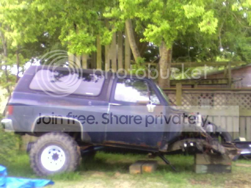

The donor 83
My tools all nice and netly laid out lol ..
Crap what Have i done now.
No more 60...
Its out and ready for transplant...

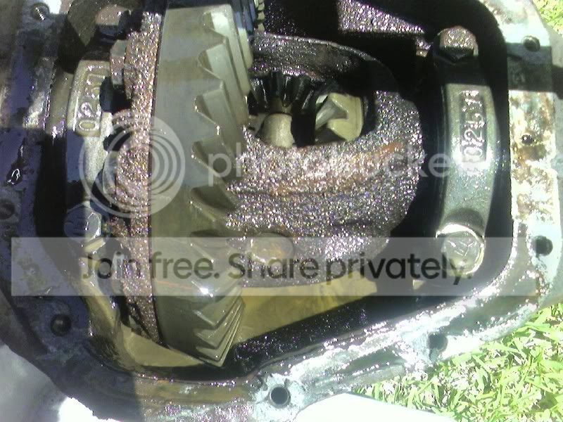

Heres the milkshake and mentioned surface rust.. almost like scale..
Poor truck... Maybe ill buggy it.. hmm :D
Upon removal of the gear box I found the infamous crack at the steering box in the frame. I also found an interesting cobbled together steering brace. It should hold for now but a set of ord braces are in my imediate future. I still need to make tabs for my ram and get them mounted as well..

Rocklogic 1.5x8 ram w/ hiems
Skycross over kit w/ studs
2wd box tapped for assist w/ lines

That's a sweet looking lime green Blazer. Keep up the good work, and post more pictures!
The table of tools all nice and neat makes me wish my stuff was organized. It looks as if your going to be wrenching like a surgeon, "Nurse hand me the 9/16"
Ya it was nice to have them all laid out helped out alot when i satred wrenchin. Though I do wish I had my tool box here instead of at work 40 miles away it sucks when you for get that one tool you need to finsh up .. :D
