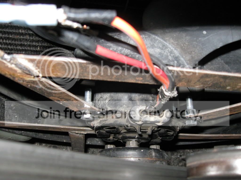

Looking down from the top

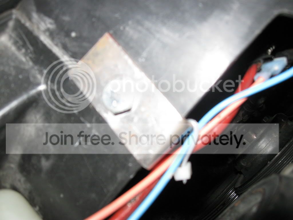

Looking from the passenger side...

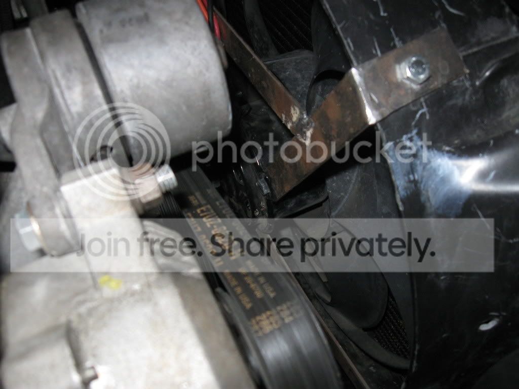

And looking from the driver's side.
I know this is a Ford, but the idea is generally the same. If you are running a small block, you might need a shallower fan shroud to keep the motor from the water pump pulley. I bolted eigth inch flat bar to the 3 holes and bent/welded them to the contour of the shroud. The top 2 pieces bolt to a hole each in the motor and the shroud, and the bottom bar bolts to the 1 hole in the motor, runs horizontal, and bolts to 2 places in the shroud. This has worked great and I use the high speed setting for it.
