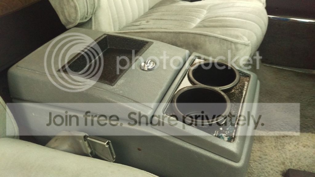

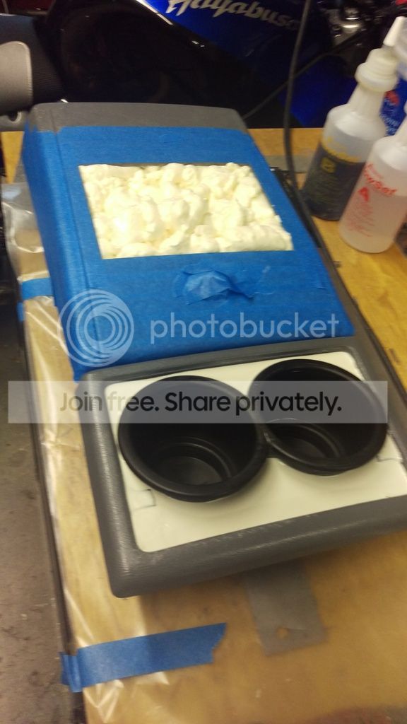

So, I started with doing a switch panel. I liked it, but once I drove around some with it, I really missed the cup holders.
So I went and purchased some expanding foam, some Alumilite epoxy, and a pair of marine cup holders.
Cut the cup holder area and the center of the console lid and filled it with foam. I cut the flanges of the cup holders to bring them together a little and fixed it together with epoxy. Also boxing out the lid for a pocket. Final was a little paint and then hitting the lid pocket with some bed liner finished it. Modern large cups and a spot for phone, glasses, and random stuff in the lid WITHOUT sliding off.
Thats awesome!! Where'd ya score the tray in the lid from?
Built it myself.
Cut a hole and filled the inside with the expanding foam. Then cut the foam oversized to leave room for the epoxy. Then formed up one side at a time and made the walls. once all four sides were done I did the floor of the pocket. Sanded it well for the bed liner, which was done over the top a little to give it a pocket look.
I can't decide if I wanna pull a mold of it to cast or if it simply would be better to do it as a vacuum mold type arrangement. No one around here is set up to do vacuum forming or mold casting. IF someone here on CK5 has the ability to get it done, I could go through the effort of making a single casting so that they could use it for production. Making a bunch for others is outside my capabilities.

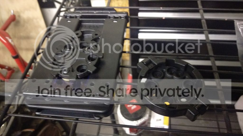

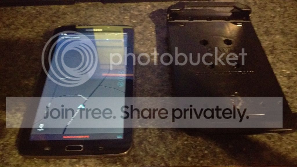

First up, Galaxy Tab 3 and a Ram Mount Tab-Lite mount.

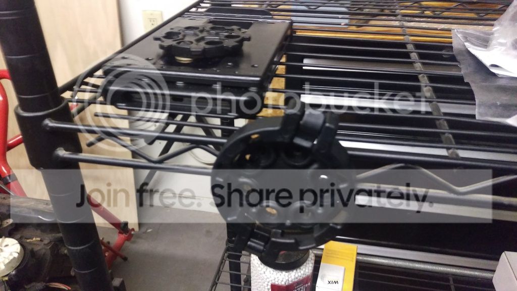

The Ram then mounts to a Blackhawk Quick Disconnect (holster mount) with it off-set mounted.

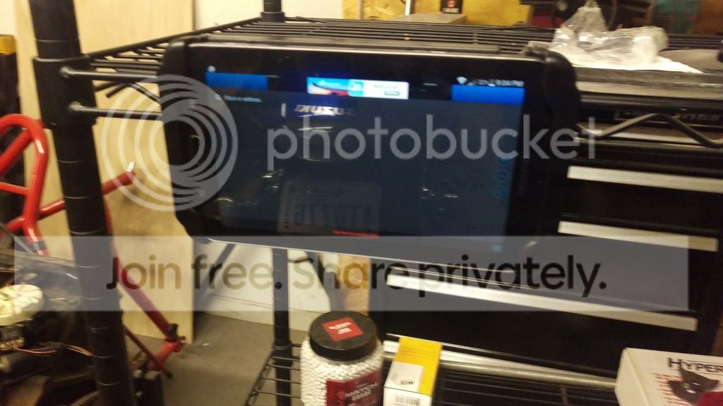

Zip tied to a shelf to give you and idea of how it works, it will be mounted just to the right of the vent and a/c controls area, and when horizontal will be above the passenger left vent.

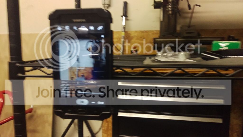

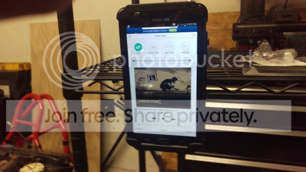

Here you can see the Tab 3 camera clears the Ram mount so I can use it as a dash-cam also. And of course the important part, the media player (and video) will link to a volume knob and amp system through a Bluetooth connection.
