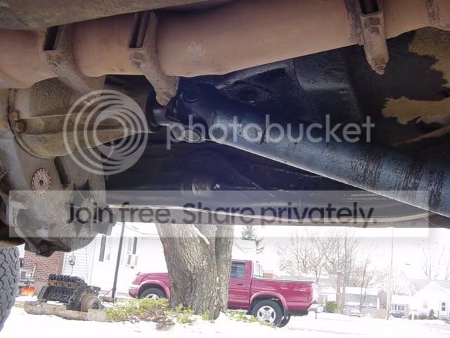

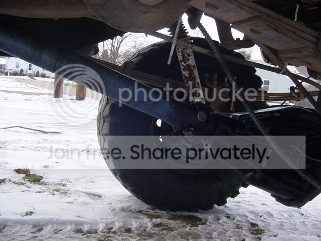

    here are pics of my angles... what will happen if i keep driving w/ the vibes?

    Yup, your problem is a driveline angle mismatch. Your pinion is angled up so your pinion ujoint angle is ~0* and your transfer case u-joint angle is at at least 5.
    You either need to rotate your pinion down so the 2 angles match, or get a CV shaft.
    What will happen is you will be annoyed and it could lead to premature u-joint failure.

    You will eat U-Joints. I got a 1350 CV shaft and no vibes and no busted u joints.

    Looking closer at your pictures, I bet that once you angle the pinion down far enough, your d-shaft will be too short.:doah: :thinking:
    Hard to say until you measure and move it.

    That angle at the t-case end looks bad. Jack the rear end up (block the front tires of course), and have someone get on the gas while you look and listen under the truck. I bet its comming from the t-case and not the diff. The easiest way to solve your problem would be to get a cv shaft made. It fixed mine. Oh, and left unattended, it will eat u-joints, and can kill the seal in the tailshaft of the 208. That will make you lose a lot of tranny fluid. Unnoticed, it could kill your t-case. :doah:

    it almost looks like your angle at the diff is slightly above 0*
    could probally use a slight downward angle to that and of course a cv joint at the tcase end
