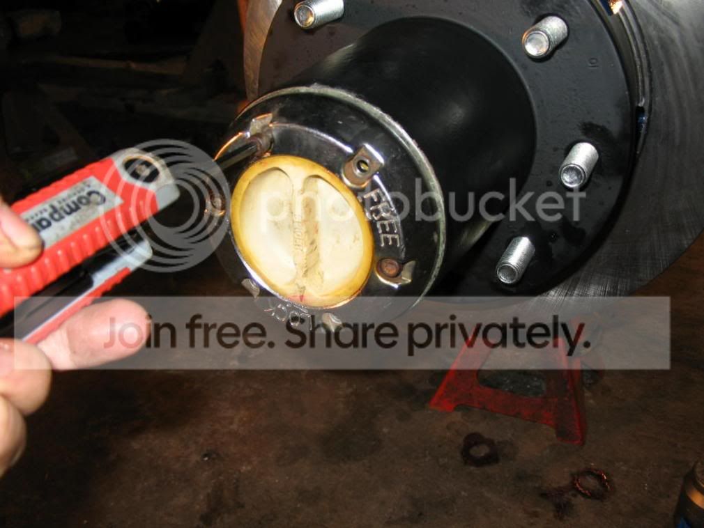

Not sure, but they are supposed to be the strongest locking hub for 30 spline stuff. They are pretty beefy inside.
The Spicer hub can be more difficult to turn than other aftermarket hubs, especially if neglected. Most of the knobs I've seen broken were because the user turned them with pliers and twisted the center out.
(I realize my pm stated "all steel construction", I was referring to the internal gears. The knob itself is indeed plastic.)

The secret to these hubs is DO NOT TO OVER GREASE...the internal gears...........otherwise in winter time grease hardends up....causing the knob to turn hard....or not to turn at all......so guys use pliers and end up busting the plastic dial on the inside.............and I've only ever seen this happen on the large Dana HD44 hub's....since their knob design is different than the smaller 1/2 ton....and 1 ton dana 60 knobs.
