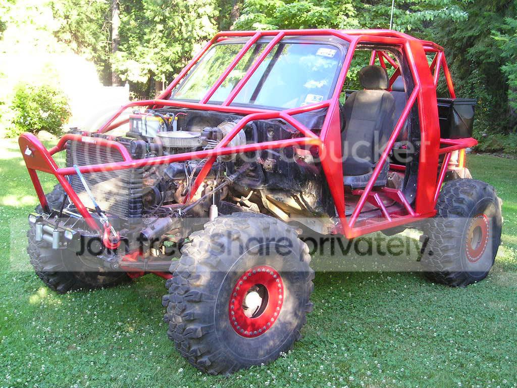

A truggy is a mix between a truck and a buggy. They usually have minimal body panels left, exo cages, and are used for hardcore trails.

Truggy (not mine)=
