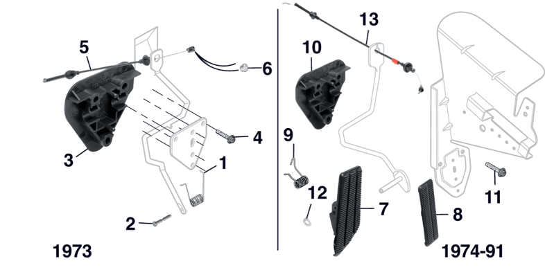

My gas pedal is heavy as hell. Always has been, but seems to be getting worse and sticking. Been looking around on here and lokar cables seem to help a lot of times.
Trying to figure out which is correct for a 89 Jimmy TBI 350 with a stock pedal. Anyone know? And do I have to switch out the bracket or anything? Seems like everything on the lokar is circular but everything on the stock cable is square/rectangular

sorry I don’t know lokar part number, but would assume you can use the lokar bracket mounted to the intake and you’ll have to get creative with the rectangle firewall grommet.

my concern about using the lokar bracket is I’m not planning on replacing the other cable (TV?) that shares the factory bracket. So I’d potentially have issues there.
mine used to do this, it was the cable cutting into itself and after the 3rd cable i bought a lokar and cut to fit no issues since
Do you remember if you could use your stock bracket/pedal? I may just order one and figure it out from there, but they aren’t cheap (for a cable) so I thought I’d check if anyone had details.
Yes, I took the plastic piece that hooks to the stock pedal and used it, you have to cut it off stock pedal but you dont need stock one any more
also you need 2 big washers so that when it goes though the firewall it doesnt give you grief .
one outside one inside to accommodate square hole round cable situation
Also before you run the cable but have the two pieces bolted to the firewall take a wrench and put on it and Bend it so the cable thing points up and not down the cable will saw into the housing at extreme angle and stop the peddle from working
