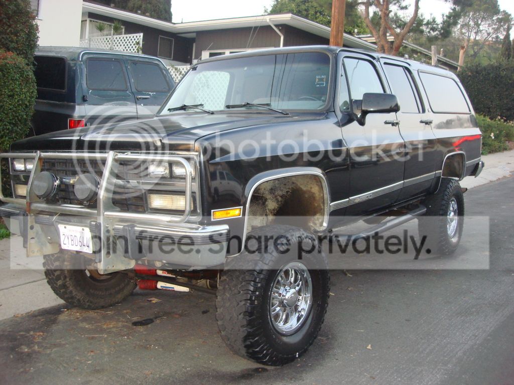

Buy mine fly down and drive it up will make it no problem:thumb:
