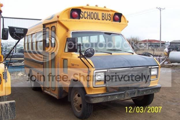

I just picked this up as my tow Rig, not a daily driver by any means but has a 7.3 non turbo and auto trans, plus lots of room for tools and extras:grin:
