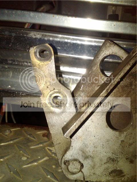

this is the old booster bracket with the lever the rod that bent pushes on, the pivot pin was completely rusted and seized i belive it bound up and when i stomped on the brake the rod is what gave.

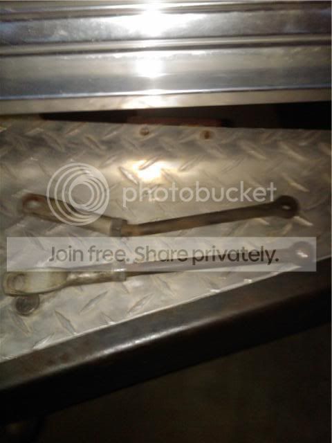

the carnage compared to the new onw

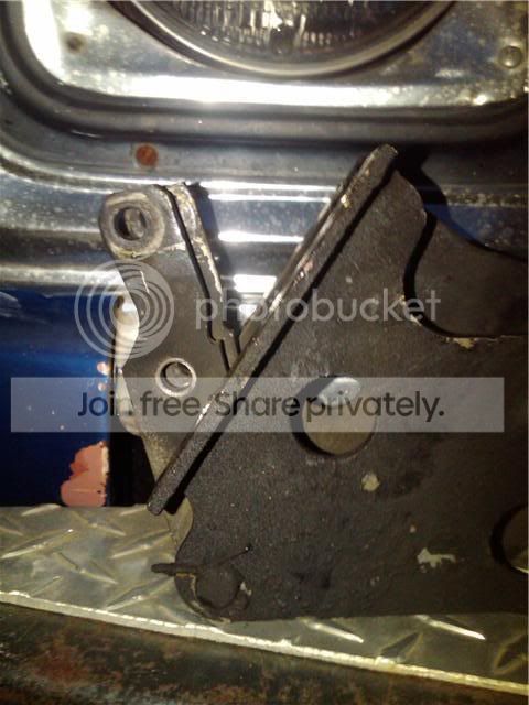

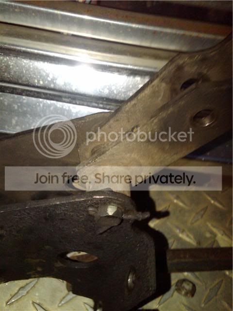

and i have a second question, this also may have lead to the failue, this is what i removed, the levers are facing the opposite direction of the one bill sent me id like a third opinion if anyone has a similar year truck to verify which way they face on thiers
old booster bracket and levers
new one and levers
