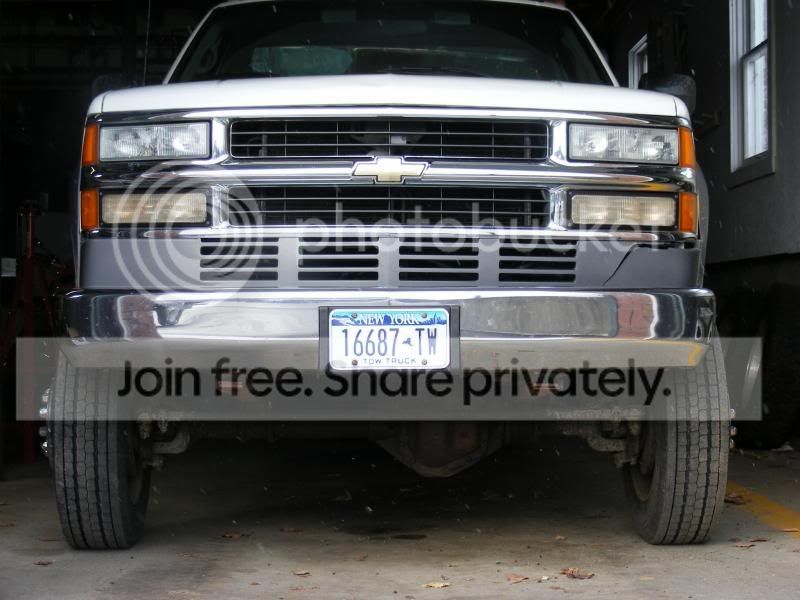

I have a buddy looking for a 10 lug open knuckle kingpin Dana 70. They were found under some of the '90's GM conversions and later 4wd Kodiaks. He wants to 4wd his C3500HD for a kick ass plow rig. If you have or know someone who has one drop me a PM.

here is a pic of a Monroe I found cruising google
